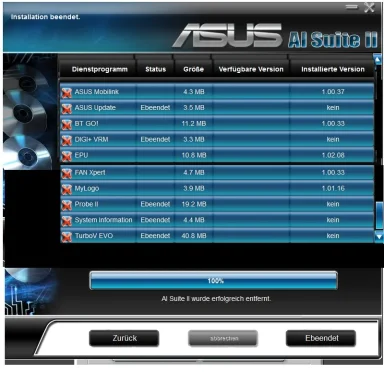

I suppose I am still working on getting rid of the ASUS suite. As per the explanation, the ASUS Suite encountered a failed uninstall prior to the renaming of the ASIO and ASUpIO. Since it did not seem to matter, you have returned the file names to normal?
I will still assume the primary Suite setup utility will not run correctly? I have attached a picture of the uninstall utility, which you used to attempt the uninstall or removal. Does it look the same as yours?
I have pretty much decided the asacpi file is causing the problem. Since we cannot seem to get rid of it, we aren't getting very far. If you could find the service and stop it for testing, that would be great. Maybe in the Device Manager, like the other two, or in the Services panel. A complete uninstall would, of course, take care of the problem, if we could get that to work.

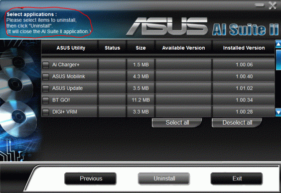

I think it's missing, isn't it?

Saltgrass
Excellent Member
Microsoft Community Contributor
Oct 16, 2009
15,155
I started my uninstaller from the Start Menu - All Programs - ASUS - ASUS Suite II - Uninstall option.
Since we have a different version of the utility, it may not be that way on yours.

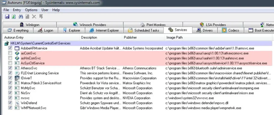

Just in this moment I've installed the autoruns. I've de-activated the red-marked parts (u.a. asio and asupio ...) - now start again and look what will happen....
My ASSuite won't start anymore - I get the error message "access violation..... - the one I've posted earlier...
So - I've now have shut down the PC and startet new (no reboot).
First: no BSoD
Then: message "cannot open asio.sys"...
Then: Can not load asacpi.dll --> Select OK
Then: AI Suite does not work anymore. (select: Close Programm)
If I now try to start the "Uninstall" from the ASSuite - nothing happens, nothing starts....
That's the situation in the moment. Now we have to fix these little things ......

Saltgrass
Excellent Member
Oct 16, 2009
15,155
If it was me, I would leave ASio and Asupio alone and let them run normally. Make sure and recheck the other three you show as unchecked. Try to get your system back to where it was originally. A partial uninstall may not make that possible, but you need to try. You did say the files you renamed earlier had been renamed correctly? The new version does not install the asacpi driver, so I think they learned a lesson.
Did you ever get where you could try uninstalling in Safe Mode?
Did the Asacpi entry show up in Autoruns?
I think the autorunsc is a command application.

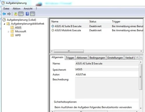

I went to the "scheduled tasks" in my System Manager and found there the ASUS-Parts............
I have deactived both (see *jpg) - and after the next re-start --> no messages, no errors, no BSoD....
I am careful with singing "Halleluja" and wait till the next start tomorrow - but it seems that the AISuite is killed in the moment.
