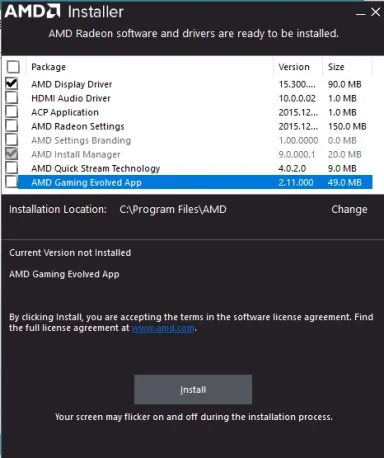

just wanna make sure i installed the right stuff only. uploaded the pic of installation
I'd be installing radeon settings if I were you. Cards fairly useless with it. I'd have installed everything except gaming evolved/raptr
Actually i wouldn't worry too much about that as this is simply an experiment.
