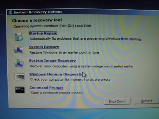

You should be getting to the page like the attachment. That is the "Startup Repair" as you can see it listed.
You do need to restart after running a repair, the system needs to set in place the prior changes before it can complete other needed ones.
