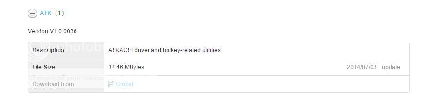

Still the same error but i also notice drivers which you have still failed to update:
ASMMAP64.sys Thu Jul 02 10:13:26 2009: Asus ATK Hotkey ATK0101 ACPI UTILITY please update:
http://www.asus.com/Notebooks_Ultrabooks/G551JM/HelpDesk_Download/
Look under ATK.
Try the other ASUS utilities as there is another Hotkey driver under utilities too but there are definitely 2013/2014 updates because i actually downloaded them and checked.
Look under ATK.

[edit] Just an aside here, but upon closer inspection of the updated ATK Package install, it would seem (unless I did something horribly wrong) the same ASMMAP64.sys driver is installed/included (July 2, 2009). Could be why adobesmurf's dump still shows the old driver. [/edit]

The thing that bugs me about it is that on the support page it clearly says 2014 next to the download and so one assumes naturally that this is the date of the driver release. It does seem a bit odd..
