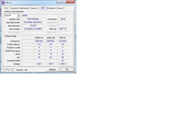

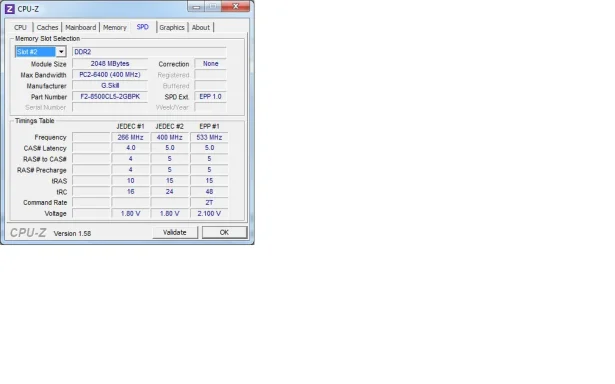

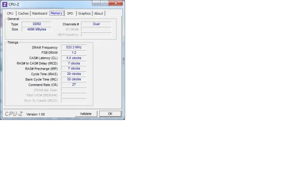

Hello!
Here's the story. Newly formatted pc. Installed nForce drivers for 780i, Geforce drivers for the video card, and drivers for soundcard. I was updating via Windows update; Bam! BSOD.
All the relevent info is in the attached zip, using the SF Diag tool.
If there's anything more that I can provide, let me know. Oh, and also, CPU-Z Ram 'shots.

Looks like it may be an issue with your memory settings:
According to the images you have posted
your memory is currently running at 533MHz and timings of 5, 7, 7, 20 and perhaps even 2.1 volts (not sure of that one though)
You may want to try toggling of EPP in the system BIOS and setting the memory as per manufacturer's specs manually which I think are 400 Mhz 5, 5, 5, 20 and 1.8 volts. Although you have only posted slot #! of the SPD tabs and it would appear that you have four gigs of memory which would indicate you have another slot poplulated so we should see that one as well and the zipped up copy of the exported HTML report for RAMMon.

#4
Hello!
Thanks for the quick replies.
UPDATE: I got another BSOD. SF Diag is crashing with an exception on MSInfo32, and now I can't get any of the other "relevant" information, so I manually pasted the new minidump file in for the new BSOD.
@SaltGrass: I have 3 monitors in total and I usually use them for work.
I can try disconnecting them, but could it really be a monitor causing the problem?
The computer boots correctly, so I can boot in either safe mode and normal mode.
The BSODs seem to come up randomly.
@Trouble: The ram I currently have is G.SKILL-ProductsI think PC8500 is suppose to be 1066Mhz, is that right? That's also what I see them rated as on the site.
I find it odd that CPU-Z says max bandwidth 400mhz, but they're probably going by JEDEC standards, right?
Because then we get SPD Ext. EPP1.0. , meaning it can go up to 533? Ok sorry for the questions. I'll try toggling EPP and lowering everything down.
I definitely forgot to post that second tab, which will be in the present post .
Sadly, I own an Auzentech Prelude 7.1, and they seem to have made their latest drivers in December 2010. I had found a modified driver at one point, but I was still getting BSODs so I ditched it.
Finally, Rammon does not seem to open. It opens up as a processor but then shuts down. Not really sure why.
EDIT: I noticed upon fixing my memory speed that EPP was in fact NOT turned on (they list it as SLI-Ready Memory)? This setting was set to disable, and yet they were running at 1066Mhz. Now I enabled it, with CPUOC 0%. Still running at 1066 Mhz. Should I redisable it and lower everything down to 800Mhz?
Thanks again for the help.
Very appreciated.
Sincerely,
Mox
