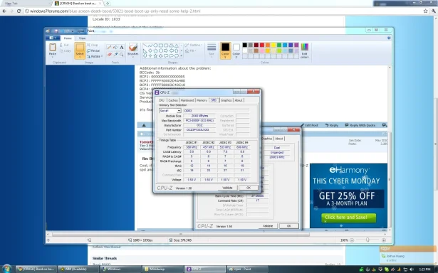

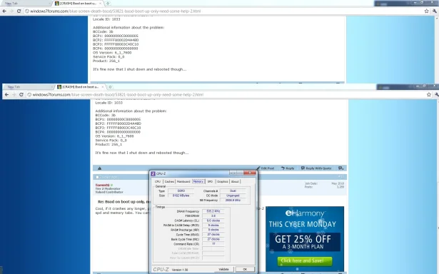

Cool, if it crashes any longer, post the new crash dumps but also include a screen shot of CPU-Z spd and memory tabs. You can attach the jpegs directly.
#13
Yeah...it bsod'ed again, this time it did it before I could get into windows. Here are the dumps and screen shots.

Go in the bios and set the timings to be 7-7-7-16 and save.
If that doesn't fix it, then either this driver is at issue or the memory is defective:
SaiH8000 SaiH8000.sys Fri Apr 04 07:26:34 2008
Remove that driver and/or test with Memtest86+.

Those Saitek drivers are usually for gamepads, not keyboard....unless you are sure you have a keyboard from them.
Anyhow, when the timings are wrong and the memory is not warmed up, that is what is creating the issue. The issue can become masked with improper timings when the memory is warmed.
