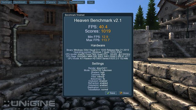

After reading the above I went back and tested Heaven again.
This the set up for first run:
Link Removed due to 404 Error
Result is as follows:
I then backed the Tessellation slider off to 2x and ran the test again:
The result is as follows:
As you can see there is a significant increase although I did notice that when I first tried to run the test at 2x the results returned back unchanged. I then checked the settings and discovered that the catalyst tesselation setting had jumped back into it's default position. Perhaps you were getting the same issue?

Your max frames is showing higher in the 2x! I also wouldn't make much of the minimum figure as that tends to be a bit all over the place anyway. Run Heaven with fraps or something and you'll see that there is more fps at 2x. Stands to reason I guess as the engine isn't having to work so hard with the Tesselation turned down.
Take a look at these two shots here:
Notice the Tesselation and frame count 64x
Ok, again look at the Tessellation and frame count 2x.
See how the Tessellation is ramped back?

There is certainly some difference like +- 15 FPS in the current frame rate and that's noticeable. The current frame count sure matters but I also judge by our final results:
yours - Link Removed - Invalid URL Link Removed - Invalid URL
mine - 2x 64x
Overall yes, different tesselation levels yield different results. I would not even try to deny that. : )
