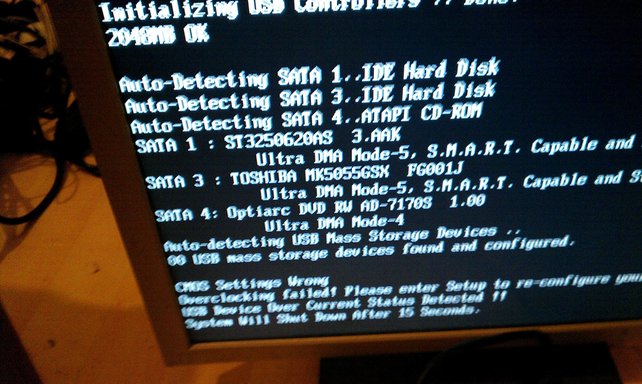

    When starting computer, I get what you can see on the picture.
    CMOS settings wrong. Overclocking failed etc..
    I tried with reseting CMOS (battery out/in, jumpers on the motherboard switched) but it didnt' help. Also tried coming to settings (holding 'Delete' key), also helpless.

    If you have followed you motherboard documentation regarding resetting the BIOS, as well as, as you have suggested, removing all external power sources from the motherboard and removing the battery for 10 minutes or so, then my only guess would be that something may have corrupted the BIOS chip, a failed firmware flash, or an electrical mishap like a spike or short.
    Is this a new build? Has it ever worked? I assume you have already disconnected any USB cables from all USB ports on the board? Can you provide some specifics as to Manufacturer Name, Model Name and Number, Revision Number, etc., for the board you are using, it's possible someone might have some specific experience with the same or similar product. Other than that it may be RMA time if that option is available to you.

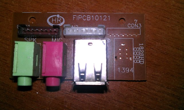

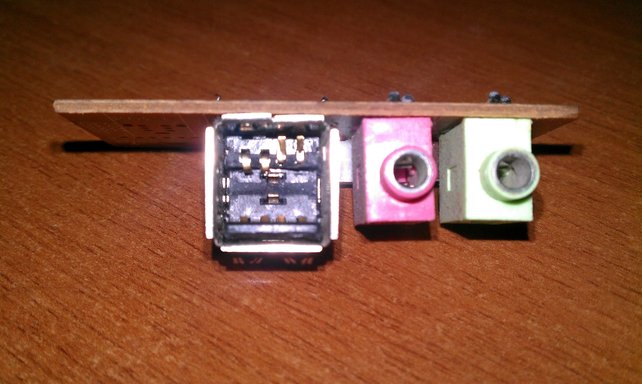

    As I assumed, broken USB connector (on chip) didn't "cooperate" well with motherboard. I removed it and now computer works ok.
