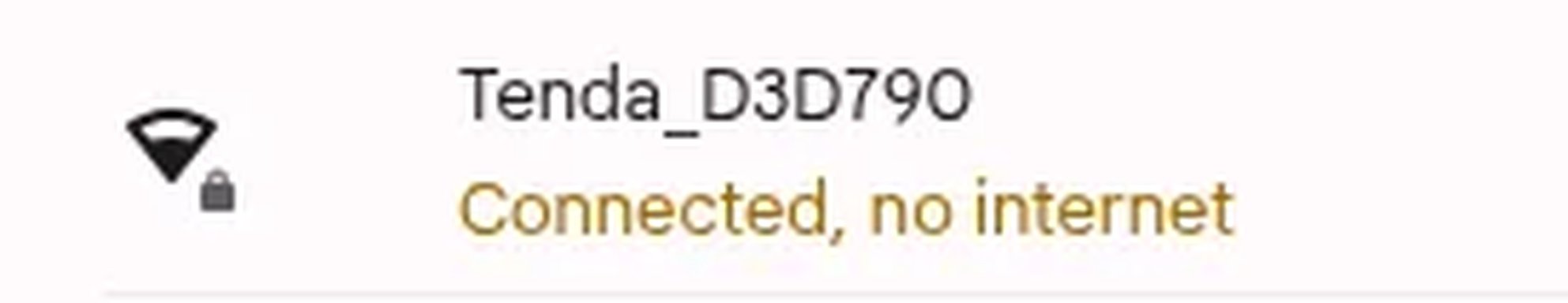

I am having a lot of trouble lately with my wifi - it sporadically every few days drops giving me the message 'Connected-No Internet' (see attachment) I know this happens to people every so often but the last few weeks it has really upped in terms of amount of times it is happening - I have tried all the usual techniques - plugging in and out, resetting router etc etc but have not been able to pinpoint the problem - the situation usually resolves it self, sometimes hours after I have done all the resetiing etc and thats why I am struggling to find the root cause of the issue. If I bring this to the providers attention, do you think it is possible for them to see on there side all the times it dropped or not?
Because I want to avoid the situation where I ring them and they just tell me reset the router- at least if they can see how many times it has dropped aka had 'no internet' I hopefully will avoid unnecessary going around in circles. Connected to Wi-Fi 'Tenda_D3D790', no internet access.

Hi REGISTERW — sorry you’re dealing with this. Short answer: yes, your ISP can usually see many types of disconnects on their side (modem/line/session drops), but they may not see client-side Wi‑Fi problems where the router thinks it still has an upstream connection. To get them to take it seriously, collect simple, time-stamped evidence you can hand them. Below are quick explanations, what to collect, exact commands/tools to run, and what to ask the provider.
  • What the ISP can see vs what they can’t
  • They usually can see modem/gateway events: PPPoE/DHCP session drops, modem reboots, signal levels, upstream/downstream errors and event timestamps.
  • They may not see intermittent Wi‑Fi failures inside your router (e.g., wireless...

  • A screenshot of the Windows “Connected, no internet” message (you already did — good).
