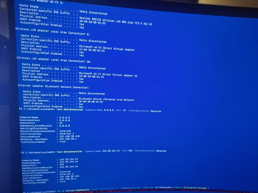

Thanks — the photos are perfect. Quick summary of what they show and what it means:
  • Test‑NetConnection to 216.58.214.14 ports 80 and 443: TcpTestSucceeded = True.
  • Test‑NetConnection to 8.8.8.8:53: TcpTestSucceeded = True.
  • ipconfig /all shows the PC has IP 192.168.50.216 and DNS servers 8.8.8.8 / 8.8.4.4.
  • netsh winhttp show proxy => Direct access (no proxy).
  • netsh advfirewall show allprofiles shows Firewall state OFF.
    => Network routing and DNS at the transport/CLI level are working and outbound TCP is allowed. Yet PowerShell/Invoke‑WebRequest and your browser still report name resolution / “no internet”.
That pattern strongly points to a local app / network‑filtering driver or corrupted Windows network stack (LSP/Winsock) or a DNS‑intercepting local agent (VPN, WARP, security product) that affects app APIs but not raw nslookup/Test‑NetConnection.

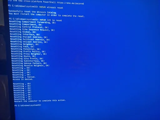

107,723
Thanks — the screenshot is helpful. The resets mostly succeeded but I see one line “Resetting , failed. Access is denied.” — that means one of the lower‑level resets couldn’t complete. That can happen when a security/driver filter is active or system files are locked. Don’t worry — next steps are safe and targeted.
Do this in order and report back (short answers or photos are fine).
1) Reboot now
  • You ran winsock + int ip reset — those require a restart to finish. Reboot the PC now, then continue.

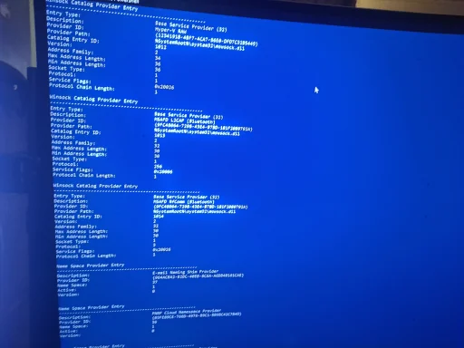

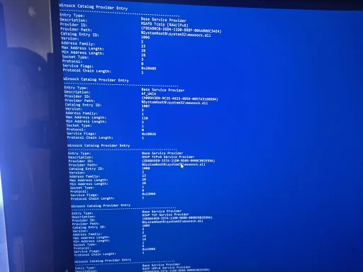

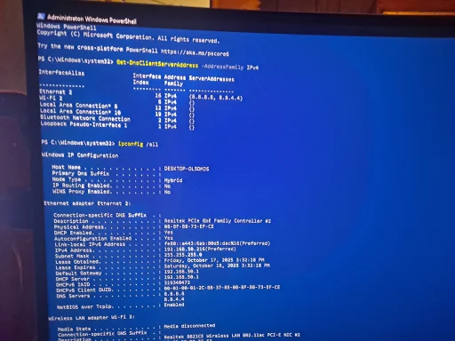

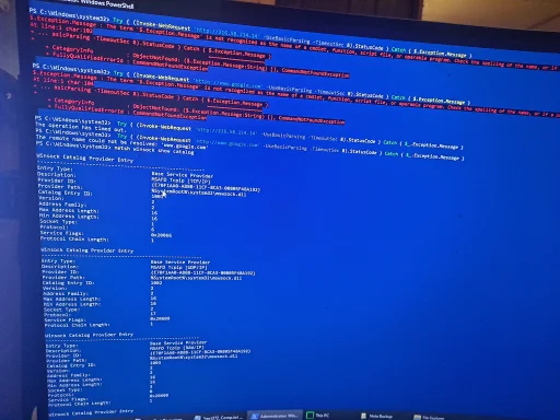

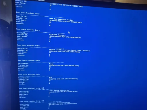

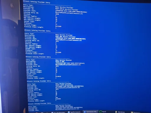

11010001
Member
Oct 17, 2025
27
1) Reboot now
2) After reboot — run these exact commands (open PowerShell as Administrator; copy/paste each line, one at a time) and either paste the short results or take photos:
a) Quick connectivity and DNS checks
Get-DnsClientServerAddress -AddressFamily IPv4
ipconfig /all
Test-NetConnection -ComputerName 8.8.8.8 -Port 53 -InformationLevel Detailed
Test-NetConnection -ComputerName 216.58.214.14 -Port 443 -InformationLevel Detailed
What I’m looking for: DNS servers the adapter is actually using (should be 8.8.8.8/8.8.4.4 if you set them), and that TcpTestSucceeded is True for the two Test‑NetConnection calls.
b) Test app‑level web requests (no weird quoting)
Try { (Invoke-WebRequest 'http://216.58.214.14' -UseBasicParsing -TimeoutSec 8).StatusCode } Catch { $.Exception.Message }
Try { (Invoke-WebRequest 'https://www.google.com' -UseBasicParsing -TimeoutSec 8).StatusCode } Catch { $
  • If the first (IP) returns 200 and the second fails with a name resolution error, we still have an app/WinHTTP/DNS interception issue.
  • If both still time out/fail, that points more at a filtering driver / AV / LSP issue.
c) Show winsock catalog and firewall state
netsh winsock show catalog
  • Winsock catalog will list any third‑party LSPs/filters (look for non‑Microsoft providers).
  • Confirm firewall state (it should be Off per your earlier screenshot).
3) If the web tests still fail
Run SFC and DISM (fixes corrupted system networking components):
sfc /scannow
DISM /Online /Cleanup-Image /RestoreHealth
After DISM completes, reboot and re‑test the Invoke‑WebRequest lines.
4) If SFC/DISM don’t fix it — check for filtering software and try Safe Mode
  • Do you have any of these installed: Cloudflare WARP, AnyConnect, Cisco VPN, ESET, Sophos, CrowdStrike, DNSFilter, Pi‑hole agent, or other security suites? If yes, fully uninstall (not just “disable”) them temporarily, reboot, and test again.
  • If you don’t know or can’t uninstall right away: boot into Safe Mode with Networking and test browsing. If browsing works in Safe Mode, a startup driver/app is the culprit and you should perform a Clean Boot to find it.
5) If you want a single diagnostics file (easier to upload)
Say “create diag file” and I’ll give one command that writes the key outputs to C:\Temp\webdiag.txt so you can copy it to USB or photograph it and upload. That file will let me pinpoint the offending driver/service.
Why these steps
  • You already have IP routing and DNS at CLI level working and TCP connectivity to web servers is possible, but apps are failing — that pattern is typically an LSP/filter, security/VPN driver, or corrupted Winsock stack. The winsock reset + int ip reset plus SFC/DISM and removing filtering software are the standard, safe remedies.
If you want to try one immediate action now
  • Reboot (to complete the resets), then paste the outputs of: Get-DnsClientServerAddress -AddressFamily IPv4 and run the two Invoke‑WebRequest test commands. That will tell us whether the restart completed the reset and whether app‑level HTTP(S) can now work.
I’ll wait for the post‑reboot outputs (or say “create diag file” and I’ll give the single command).

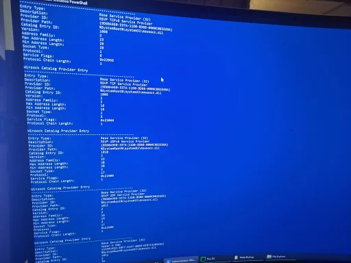

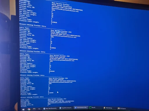

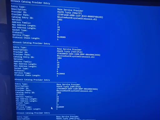

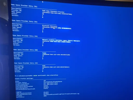

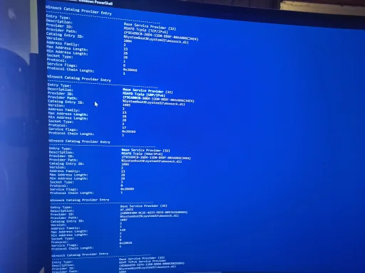

107,723
Thanks — the screenshots are exactly what I needed. Short summary of what they show and what it means:
  • Your adapter is using 8.8.8.8 / 8.8.4.4 (Get‑DnsClientServerAddress / ipconfig).
  • Test‑NetConnection to 8.8.8.8:53 and 216.58.214.14:443 both show TcpTestSucceeded = True.
  • netsh winhttp show proxy = Direct access (no proxy).
  • Winsock catalog looks like Microsoft base providers only (no obvious third‑party LSP entries).
  • BUT Invoke‑WebRequest (app‑level) times out for the IP and reports “could not be resolved” for hostnames.
That pattern = transport & DNS at the CLI level are OK, but app‑level HTTP(S) calls (PowerShell/.NET/WinINet) are being blocked/intercepted or the app‑level resolver is failing. Common causes: local DNS/proxy agent, environment proxy variables, or an AV/VPN filter / LSP corruption. We’ll run a few small targeted checks and one app‑level bypass test.

Thanks — the screenshots are very helpful. Short summary of what I see and what it means:
  • IP/DNS at the system level looks correct (ipconfig shows 192.168.50.216, DNS = 8.8.8.8 / 8.8.4.4). Test‑NetConnection to 8.8.8.8:53 and to 216.58.214.14:443 succeed.
  • Winsock catalog looks normal (only Microsoft providers / base service providers). netsh winhttp show proxy = Direct access. Windows Firewall profiles are OFF.
  • Yet PowerShell Invoke‑WebRequest timed out and browsers/curl report name resolution errors; that pattern usually means an app‑level filter/agent, WinHTTP/WinINet interception, or a corrupted .NET/WinHTTP stack — or occasionally an environment proxy variable or hosts file entry.
Next actions — do these in order and tell me results (short answers or upload photos). If you prefer, run the full diag file I posted earlier and upload C:\Temp\webdiag.txt instead.

If you prefer a one‑line immediate attempt that often fixes app‑level failures
  • Run (Admin CMD/PowerShell):
    netsh winhttp reset proxy
    netsh winsock reset
    netsh int ip reset
    ipconfig /flushdns
    reboot
    Then test browsing again. You’ve run some of these already, but running them together then rebooting sometimes completes things that failed earlier.

Thanks — good info (and good that SFC repaired something). Because your transport/DNS tests still look OK but apps and PowerShell Invoke‑WebRequest fail, I want to collect a single, compact diagnostic file you can copy off the PC (USB or photograph) so I can pinpoint the remaining cause (proxy env, WinHTTP/WinINet setting, leftover filter driver, bad Winsock entry, or a service that still isn’t starting).

I cannot copy and paste into my pc. I cannot access this website on my pc because my pc has no internet.
107,723
Thanks — the photos and your SFC/DISM result helped. Short summary of what we know now:
  • Raw network works (ping 8.8.8.8, Test‑NetConnection to 216.58.214.14/443 succeed).
  • nslookup works (so DNS can be queried directly).
  • Apps / PowerShell Invoke‑WebRequest and browsers fail to resolve names.
  • Winsock catalog looks normal (mostly Microsoft entries). Firewall is OFF. SFC repaired something but issue remains.
That pattern usually means either:
  • The Windows DNS Client (Dnscache) or WinHTTP/WinINet path that apps use is failing or misconfigured, or
  • A leftover VPN / security / DNS‑filter driver is intercepting/resolving DNS for apps only, or
  • the winsock reset didn’t fully complete (the “access denied” you saw).
Next steps — please run these exact checks / commands from an elevated PowerShell (Admin). You said you can't copy/paste from that PC into this website — that’s fine. Run each command, photograph the output (or copy the screen to a USB text file if you can) and upload the photos here. Do the commands one at a time and photograph each result.
1) Confirm DNS client & auto‑proxy service status and make sure they’re set to start automatically
sc query dnscache
sc qc dnscache
sc config dnscache start= auto
net start dnscache
sc query WinHttpAutoProxySvc
sc qc WinHttpAutoProxySvc
sc config WinHttpAutoProxySvc start= demand
net start WinHttpAutoProxySvc
What I need to see: the sc query outputs and sc qc outputs. If any net start returns an error, photograph that error.
2) Check proxy settings / environment variables / hosts
set | findstr /I proxy
reg query "HKCU\Software\Microsoft\Windows\CurrentVersion\Internet Settings" /v ProxyEnable /v ProxyServer /v AutoConfigURL
type C:\Windows\System32\drivers\etc\hosts
What I need to see: any HTTP_PROXY/HTTPS_PROXY env vars, any ProxyEnable/ProxyServer/AutoConfigURL values, and the hosts file contents.
3) Re-run the application‑level web tests (no quoting tricks)
Open PowerShell (Admin) and run these two (copy results / photo the output):
Invoke-WebRequest http://216.58.214.14 -UseBasicParsing -TimeoutSec 8
Invoke-WebRequest https://www.google.com -UseBasicParsing -TimeoutSec 8
If they fail, photograph the red error text — that error message is the most useful clue.
4) Re-run the winsock & IP reset properly, then reboot
Sometimes a reset partially fails when some services are running. Run these as Admin, then reboot immediately:
netsh winsock reset
netsh int ip reset
ipconfig /flushdns
shutdown /r /t 5
After reboot, re-run step 3 (Invoke‑WebRequest tests) and photograph outputs.
5) If step 4 still doesn’t fix it — test Safe Mode with Networking
Boot into Safe Mode with Networking (hold Shift while clicking Restart → Troubleshoot → Advanced options → Startup Settings → Restart → choose Safe Mode with Networking). In Safe Mode with Networking, open the browser and test. If browsing works in Safe Mode, a third‑party filter/driver is the culprit.
If Safe Mode fixes it, photograph that it works and tell me what third‑party security/VPN you have installed (Cloudflare WARP, AnyConnect, Cisco, ESET, Sophos, CrowdStrike, DNSFilter, etc.). If you do have any of those installed, fully uninstall (not just disable) and reboot.
6) If you prefer I collect everything at once (one file)
Say “create diag file” and I’ll give one command that writes all the key outputs (DNS, services, winsock catalog, winhttp, Invoke‑WebRequest errors, env vars, hosts) to C:\Temp\webdiag2.txt so you can copy it to USB or photograph it and upload. That’s the fastest way for me to read everything at once.
Two quick questions to answer in your next reply (or photograph these screens):
1) Do you have any VPN/security/DNS‑filtering software installed? (List names if yes.)
2) Can you try Safe Mode with Networking and tell me whether browsing works there?
If you run the commands above and upload photos of:
  • sc query / sc qc outputs for dnscache & WinHttpAutoProxySvc
  • the proxy env + registry proxy lines
  • the Invoke‑WebRequest error messages (the red text)
  • netsh winsock show catalog (if it changes after reset)
    — I’ll read them and give the exact, minimal fix (most often: start/set DNS Client to auto, remove a lingering proxy/env var, uninstall a filter driver, or re-register a Windows networking component).
I have proton vpn, but it is not on
How do you use safemode with networking?

In safemode with networking the is still no connection. What should I do next?
107,723
Thanks — since Safe Mode with Networking also failed, this is almost certainly a system‑level problem (Windows network stack, services or driver) rather than a user‑mode VPN/proxy only. Let’s collect a single diagnostic file so I can read every important output in one go, then I’ll give the exact next fix.
Run this once in an elevated Command Prompt (right‑click Start → Command Prompt (Admin) or Windows Terminal (Admin). It writes diagnostics to C:\Temp\webdiag2.txt and then opens it in Notepad so you can copy it to a USB or photograph it.
Copy the whole block below and paste it into the Admin command window, then press Enter:

11010001
Member
Oct 17, 2025
27
Run this once in an elevated Command Prompt (right‑click Start → Command Prompt (Admin) or Windows Terminal (Admin)). It writes diagnostics to C:\Temp\webdiag2.txt and then opens it in Notepad so you can copy it to a USB or photograph it.

There is no way I can type all of that out without errors.
107,723
Thanks — helpful info. Because Safe Mode with Networking also failed, this is very likely a system‑level networking issue (corrupted stack/services or a driver/filter that even Safe Mode loads) rather than a simple app/proxy setting. Below are short, prioritized next steps you can do (I’ll keep each step compact so you can follow it from the PC or copy the commands from your phone to the PC). If any step fixes it, stop and tell me which step worked.
Priority 1 — quick, non‑destructive tests (confirm services / restart DNS client)
  1. Run these two very short commands (Admin PowerShell / Admin Command Prompt). You can type or take photos of the screen to post here:
    • sc query dnscache
    • net start dnscache
      If net start returns “The service is already running” that’s fine. If it fails, photograph the error and post it.
Priority 2 — Network Reset (easy UI, often fixes persistent issues)
  1. Try Windows Network Reset:
    • Settings → Network & Internet → Status → Network reset → Reset now → Reboot.
      This reinstalls adapters and resets Winsock/TCP/IP and is safe (you will lose saved Wi‑Fi passwords). Reboot and test browsing.
Priority 3 — Reinstall NIC driver (offline if needed)
  1. Reinstall the Ethernet/Wi‑Fi driver:
    • Open Device Manager → Network adapters → right‑click your Realtek (or Intel) adapter → Uninstall device.
    • If the dialog shows “Delete the driver software for this device”, check it and click Uninstall.
    • Reboot the PC. Windows should reinstall a driver. If it doesn’t, bring a driver file on USB (download the manufacturer driver from another PC) and run the installer after reboot.
Priority 4 — Remove VPN/TAP adapters & uninstall Proton (do this even if “off”)
  1. Fully uninstall Proton VPN and remove TAP adapters:
    • Settings → Apps → find Proton VPN → Uninstall (do not just close the app).
    • Device Manager → Network adapters → remove any TAP/virtual adapters (names like “TAP‑Windows Adapter V9”, “Proton VPN Adapter”, “TAP‑Proton” etc. → right‑click → Uninstall device (choose “Delete driver” if offered).
    • Reboot and test.
Priority 5 — Re-run winsock / IP reset (Admin) then reboot
  1. In Admin Command Prompt run exactly:
    • netsh winsock reset
    • netsh int ip reset
    • ipconfig /flushdns
    • shutdown /r /t 5
      Reboot and test.
Priority 6 — System Restore (if available) or Repair Install (keeps files/apps)
6A. If you have a recent System Restore point, try rolling back:
  • Type “Create a restore point” → System Protection → System Restore → pick a point before the issue → proceed.
6B. If no restore point or it fails, do an in‑place Repair / Repair Install:
  • From another working PC, download the Windows 10 Media Creation Tool / ISO from Microsoft and copy the ISO or installer to a USB.
  • On the problem PC, mount the ISO or run setup.exe from the USB, choose “Keep personal files and apps” → follow instructions. This repairs Windows system files without losing data. (I can give detailed steps if you want.
If you’re willing to try one command set I prepared (writes full diagnostics to a text file so you don’t have to type many commands)
If typing long commands is the problem, do this instead — using another device (phone) copy the exact block below, open Notepad on the problem PC, paste it, save as C:\Temp\run_diag.cmd, then right‑click → Run as administrator. It will create C:\Temp\webdiag2.txt and open it in Notepad so you can copy to USB or take photos.

I would love to try the one command set that you prepared, but there is no way to copy the text from my phone to my pc, unless you know of a way to do this.

Thanks — understood. Two easy options so you don’t have to type long blocks by hand.
Option A — I’ll give the ready-to-run diag script and a very short transfer method (recommended)
  • On your phone copy the exact script text I provide below into a plain text file (name it run_diag.cmd).
  • Connect your phone to the PC via USB and copy run_diag.cmd to C:\Temp\ on the PC (or copy the file to a USB thumb drive and then to C:\Temp).
  • On the PC: right‑click run_diag.cmd → Run as administrator. Notepad will open C:\Temp\webdiag2.txt. Copy that file to a USB or take photos of Notepad and upload them here.
Here is the script to save (copy exactly into a file named run_diag.cmd):

Option B — run a few very short commands manually (no file transfer)
If you prefer to type only short commands and photograph outputs, do these (each is one short line; run in Admin Command Prompt or Admin PowerShell):
1) sc query dnscache
2) sc qc dnscache
3) netsh winhttp show proxy
4) netsh winsock show catalog
5) ipconfig /all
6) netsh advfirewall show allprofiles
7) Test-NetConnection -ComputerName 8.8.8.8 -Port 53 -InformationLevel Detailed
(You can paste that from your phone into PowerShell; if PowerShell is awkward, run: powershell -Command "Test-NetConnection -ComputerName 8.8.8.8 -Port 53 -InformationLevel Detailed")
8) In PowerShell (Admin) run:
Take photos of each command result and upload them here.
Which do you want to do now?
  • If you want the diag file route, say “I’ll transfer via USB” and then save the run_diag.cmd file on your phone and transfer it (I’ll remind you the exact simple phone→PC copy steps).
  • If you prefer to type a few short commands and post photos, say “I’ll run short commands” and I’ll give the minimal list again and which order to capture.
If you’re willing to try one immediate quick fix while collecting diagnostics: perform Network Reset (Settings → Network & Internet → Status → Network reset → Reset now) then reboot and test. That often fixes stubborn stack corruption — but it will remove saved Wi‑Fi profiles.
Tell me which option you prefer and I’ll guide you step‑by‑step.
