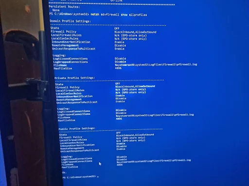

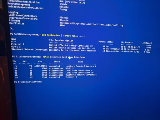

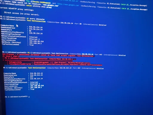

Windows 10 PC has no internet connection.
11010001
Member
Oct 17, 2025
27
I am on Windows 10 currently but am trying to upgrade to win11. Unfortunately, my pc is saying it is connected but that there is no internet access, on both wifi and ethernet. All other devices work fine, just this pc is giving me trouble.
I can still access the router settings page.
I have restarted the computer.
I have reset the router.
I have run the troubleshooter. It found nothing.
I have reset the network adapter and dns.
I have reinstalled the network adapter.
I am out of ideas.
Any help would be appreciated.

That prompt came from PowerShell waiting for you to supply a value for a parameter (Set‑Variable/Name). It happened because the script included PowerShell snippets that got executed in an interactive context. No problem — you can cancel it and we’ll run a few short, safe commands instead.
Step 1 — cancel the prompt
  • Press Ctrl+C in that window to stop the script and return to the prompt.
Step 2 — run these short commands (one at a time) in an elevated PowerShell or Admin Command Prompt, photograph each output, and upload the photos here. Don’t try to run the big script again — these are the exact small checks I need and are easy to type.
  1. DNS Client status
    sc query dnscache
  2. WinHTTP proxy
    netsh winhttp show proxy...

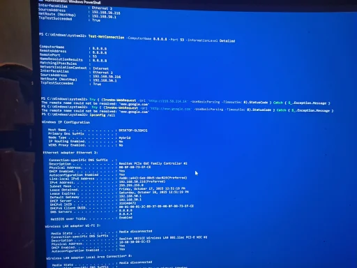

Thanks — good troubleshooting so far. Because you can open the router admin page from that PC, the NIC and local link are working, which narrows this to DNS/gateway/route, a Windows networking stack/service issue, or a firewall/proxy/VPN interfering on that Windows install. Below are targeted diagnostic steps (run in an elevated Command Prompt — right‑click Start, “Command Prompt (Admin)” or “Windows Terminal (Admin)”) and what to paste back so I can pinpoint the cause. Many of these are standard checks and resets recommended for this exact symptom.
Quick checks (do these first)
  1. Can Windows reach the router?
    • Command: ping <router IP> (usually ping 192.168.1.1)
    • Expected: replies. If this fails, check cable/adapter LEDs and try another cable/port. If it succeeds, the physical link to the router is fine.
  2. Can Windows reach the internet by IP (bypasses DNS)?
    • Command: ping 8.8.8.8
    • Expected: replies. If ping to 8.8.8.8 works but ping to google.com fails, it’s a DNS issue.
  3. DNS test
    • Command: nslookup google.com
    • Expected: it should show a DNS server and an IP for google.com. If nslookup times out or reports no servers, Windows isn’t using a valid DNS server.
Collect these outputs and paste them here if anything fails.

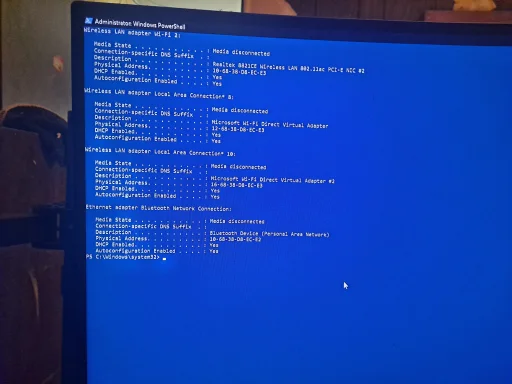

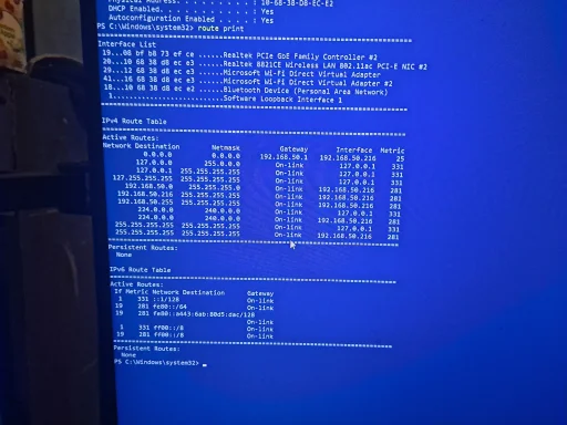

Collect diagnostic outputs (paste these)
  • ipconfig /all
  • route print
  • netsh interface ipv4 show config
  • netsh interface ipv6 show config
  • netsh interface ipv4 show dns
  • netsh interface show interface
  • sc query dhcp
  • sc query dnscache
    These show IPs, gateway, DNS servers, routing and whether DHCP/DNS services are running — the most helpful facts to diagnose this.

All three quick checks passed.

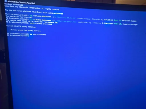

Thanks — that’s useful. Since ping to the router, ping 8.8.8.8 and nslookup all succeeded, your PC already has working IP routing and DNS — so this is likely the Network Connectivity Status Indicator (NCSI) / Windows connectivity detection, a blocked probe (proxy/firewall/hosts), or a service/config issue rather than a physical or ISP problem. That’s a common cause when Windows says “No internet” but pings and DNS succeed.
Please run these quick checks and paste back the outputs (or confirm) so I can tell you the exact fix.
1) Can you browse right now?
2) Test the NCSI probes (what Windows uses to detect “internet”):
3) Check NLA / network services and the active probing registry key
  • Run (Admin CMD):
    • sc query nlasvc
    • sc query netprofm
    • reg query "HKLM\SYSTEM\CurrentControlSet\Services\NlaSvc\Parameters\Internet" /v EnableActiveProbing
  • Expected:
    • nlasvc and netprofm should be RUNNING.
    • EnableActiveProbing should be 0x1 (decimal 1). If it’s 0, Windows won’t perform the active probe and may show No Internet.
If EnableActiveProbing = 0, re-enable it:
  • reg add "HKLM\SYSTEM\CurrentControlSet\Services\NlaSvc\Parameters\Internet" /v EnableActiveProbing /t REG_DWORD /d 1 /f
  • Reboot.
4) Quick hosts / WinHTTP / firewall checks
  • Hosts file: open C:\Windows\System32\drivers\etc\hosts and ensure no lines redirect or block msftncsi or msftconnecttest domains.
  • Show WinHTTP proxy: netsh winhttp show proxy
    • If a proxy is present you don’t expect, clear it: netsh winhttp reset proxy
  • Temporarily disable firewall (test only): netsh advfirewall set allprofiles state off
    • Test browsing/NCSI probes; then re‑enable: netsh advfirewall set allprofiles state on
  • Also temporarily disable any 3rd‑party AV/VPN and retry.
5) If you want me to verify routing/DNS from the system, paste these outputs:
  • ipconfig /all
  • route print
  • the results of the curl tests above (or copy/paste the error text)
If those tests show the problem (for example NCSI probes fail or EnableActiveProbing = 0 or a proxy/firewall is blocking), I’ll give the exact command to fix it. If everything above looks normal but Windows still reports “No internet” despite browsing working, a Network Reset or re‑enabling NLA via registry + reboot normally clears the false negative.
Tell me the results of the browser + curl checks and paste the requested outputs and I’ll give the precise next step.

I cannot browse.
The curl tests fail. (Could not resolve host)
The NLA/network services pass
I do not understand the open hosts step
There is no proxy server.
Diableing firewall doesn't help
I cannot copy/paste as I cannot post from the computer in question.
108,471
Thanks — that’s helpful. Two quick points before the steps:
  • “Could not resolve host” from curl + inability to browse means DNS resolution is failing right now (even though earlier nslookup succeeded). That usually means Windows is trying to use a DNS resolver that isn’t answering (local resolver, virtual adapter, or a blocked/changed DNS config), or a Windows network service/agent is interfering. Community reports point to exactly this class of problem (NCSI probes failing / WinHTTP / DNS client problems), and there’s a short checklist below that fixes most cases.
  • Because you said you can’t paste from that PC, I’ll give commands that save full diagnostics to a text file you can copy off the machine (USB/thumb drive or photograph and upload from another device). Do those first and either upload the file or tell me what you see.
Step A — gather a single diagnostic file (run as Administrator)
  1. Open Command Prompt (Admin).
  2. Run this block (copy/paste the whole block into the admin prompt). It writes useful outputs to C:\Temp\netdiag.txt:
mkdir C:\Temp 2>nul
echo ==== ipconfig /all ====
ipconfig /all

When I try to temporarily force a known public DNS I get the error:
The configured DNS server is incorrect or does not exist.
108,471
Thanks — that error message just means Windows rejected the DNS address you tried to write. Common causes are: wrong interface name, bad command syntax, using the wrong IP family (IPv6 vs IPv4), or the adapter being managed (DHCP/Group Policy/virtual adapter) so the change is refused. Let’s fix it step‑by‑step.
Short plan
1) Verify the exact adapter name or index.
2) Set DNS using PowerShell (clear, reliable).
3) Test resolution.
4) Undo (restore DHCP) if needed.
If that fails, run a few checks I asked for earlier so we can see why the system refuses DNS changes. (I’ve included the commands below.
1) Find the adapter name (one simple command)
  • Open PowerShell as Administrator and run:
    Get-NetAdapter | Format-Table -Auto
  • Note the InterfaceAlias (example: "Ethernet" or "Wi‑Fi") you want to change.
2) Set Google DNS (recommended method)
  • In the same elevated PowerShell run (replace InterfaceAlias with the name you found):
    Set-DnsClientServerAddress -InterfaceAlias "Ethernet" -ServerAddresses ("8.8.8.8","8.8.4.4")
  • This is the modern, reliable way to set DNS on Windows. If it succeeds, flush cache:
    ipconfig /flushdns
  • Test with:
    nslookup google.com
    nslookup google.com 8.8.8.8
(Forum guidance shows both netsh and PowerShell ways to change DNS — the PowerShell method above is less fragile and avoids name/quoting problems.
3) If you prefer netsh, make sure the interface name is exact
  • List interfaces and names:
    netsh interface ipv4 show interfaces
  • Then set DNS using the exact name shown (example):
    netsh interface ipv4 set dns name="Wi‑Fi" source=static addr=8.8.8.8
  • If netsh returns “The configured DNS server is incorrect or does not exist,” it usually means the name didn’t match an interface or the address was malformed (or the interface is locked by DHCP/GPO/virtual adapter). Using PowerShell avoids those problems.
4) If you need to revert to DHCP later
  • PowerShell:
    Set-DnsClientServerAddress -InterfaceAlias "Ethernet" -ResetServerAddresses
  • Or netsh:
    netsh interface ipv4 set dns name="Ethernet" source=dhcp
5) If the Set‑DNS command is refused or you still see resolution issues
Run these checks (copy output to a file or photograph if you can’t paste):
  • Check which DNS the adapter is using:
    Get-DnsClientServerAddress
    (or) ipconfig /all — look for the “DNS Servers” line under the active adapter.
  • Check DNS Client service:
    sc query dnscache
  • Check WinHTTP proxy:
  • Test external DNS directly:
  • If nslookup to 8.8.8.8 works but the system default nslookup fails, the adapter’s configured resolver (or a local resolver) is the issue.
6) Common causes and what to do next
  • Interface name mismatch / quoting problems — solved by using PowerShell Get-NetAdapter then Set‑DnsClientServerAddress.
  • Adapter managed by DHCP or Group Policy — you’ll get a refusal; confirm with ipconfig /all and gpresult if you suspect policies. If managed, change must come from DHCP/GPO or you must disable the policy.
  • A local DNS proxy/agent (some security suites or VPNs) set DNS to 127.0.0.1 — check ipconfig /all for 127.0.0.1. If present, that local resolver may be broken.
  • Virtual adapters / VPN clients — they sometimes hijack DNS. Disable/uninstall them temporarily and retry.
7) If you still can’t copy/paste from that PC
Create a diagnostic output file (I suggested this earlier) and move it off the PC (USB or photo). The file should include ipconfig /all, netsh winhttp show proxy, sc query dnscache, and a couple of nslookup tests — those lines tell us why DNS changes are refused. I can then point to the exact fix. (I wrote the exact diagnostic block previously — use that if useful.
If you want, do this now
1) Run in Admin PowerShell:
Set-DnsClientServerAddress -InterfaceAlias "<your adapter>" -ServerAddresses ("8.8.8.8","8.8.4.4")
ipconfig /flushdns
nslookup google.com
2) Tell me whether any command returned an error, or paste (or upload) the top lines of ipconfig /all showing “DNS Servers” and the output of sc query dnscache and netsh winhttp show proxy.
I’ll walk you through whatever the results show.
ipconfig /flushdns
nslookup google.com
I Set Google DNS and flushed the cashe but:
Nslookup google.com returns "*** google.com can't find nslookup: no response from server"
While
Nslookup google.com 8.8.8.8 retuns "Unrecognizex command: nslookup google.com 8.8.8.8"

1) Quick confirm what the adapter and DNS settings actually are
Open PowerShell (Admin) and run:
Get-DnsClientServerAddress -AddressFamily IPv4
These show the adapter name(s) and the IPv4 DNS server(s) each adapter is using. If you set DNS on the wrong adapter (Wi‑Fi vs Ethernet) it will look unchanged here. The PowerShell method is the recommended way to set DNS.
2) Test DNS resolution from the shell (non‑interactive)
Run these in PowerShell (Admin) or Command Prompt (Admin):
nslookup google.com
  • The first asks Google’s DNS (8.8.8.8) directly. The second uses your system’s configured DNS.
  • If the first succeeds and the second fails, your machine’s configured resolver is still the problem.
If you accidentally entered nslookup then typed the full command (and saw “Unrecognized command”), instead do this inside nslookup:
server 8.8.8.8
google.com
(or just run the one-line versions above from the normal shell).

Both nslookup checks pass.

Good — thanks for the update. If both nslookup tests now succeed, that tells us DNS is working now. The problem is most likely not routing/DHCP anymore but something blocking or intercepting HTTP(S) name lookups for regular apps (browser/curl) — common causes: a local DNS proxy/agent (security/VPN/WARP), WinHTTP/WinHTTP Auto‑Proxy settings, a broken network stack (Winsock/LSP), or a browser/proxy configuration. I’ll give focused tests you can run (single commands or a single diagnostic file you can copy off the PC), what each result means, and the safest fixes to try.
Quick summary (what we know)
  • You can ping the router and 8.8.8.8 and nslookup works. Good — IP routing + DNS at the CLI level are OK. .
  • Yet browsers/curl still say “could not resolve host” or fail to load pages — that points at either (A) apps using a different resolver/WinHTTP proxy, (B) a local DNS proxy/agent (127.0.0.1) that’s broken, or (C) HTTP/HTTPS blocked by a security product or service.
Run the three quick tests first (one at a time)
Run these from an elevated Command Prompt (right‑click Start → Command Prompt (Admin) or Windows Terminal (Admin).
1) Test HTTP by IP (bypasses name resolution)
  • Command:
    powershell -Command "try {Invoke-WebRequest -Uri 'http://216.58.214.14' -UseBasicParsing -TimeoutSec 8 | Select-Object StatusCode; } catch { \$_.Exception.Message }"
  • Expected:
    • If you get a numeric HTTP status or at least a response string, HTTP by IP works → name resolution or DNS proxy for apps is the issue.
    • If this fails, HTTP outbound or port 80 is being blocked.
2) Test HTTP(S) by name using PowerShell (non‑interactive):
  • Command:
    powershell -Command "try {Invoke-WebRequest -Uri 'https://www.google.com' -UseBasicParsing -TimeoutSec 8 | Select-Object StatusCode;} catch { \$_.Exception.Message }"
  • Expected:
    • Success = HTTP(S) reachable from core OS APIs; failure will show an error string we can interpret.
3) Test WinHTTP proxy and DNS client status
  • Commands:
    sc query dnscache
  • Expected:
    • netsh should show “Direct access (no proxy server)” if there is no system/WinHTTP proxy.
    • dnscache should be RUNNING. If not, start it and test again.
If you prefer to run one command that collects everything (recommended since you said you can’t paste) — create a diagnostics file you can copy to USB or photograph:
Full diagnostic block (run as Admin — writes C:\Temp\webdiag.txt)
1) Open Admin Command Prompt and paste the whole block:
mkdir C:\Temp 2>nul
echo ==== date/time ====
date /T & time /T
echo.
ipconfig /all
echo.
echo ==== Get adapter + DNS (PowerShell) ====
powershell -Command "Get-NetAdapter | Format-Table -Auto"
powershell -Command "Get-DnsClientServerAddress -AddressFamily IPv4 | Format-List"
echo.
echo ==== netsh winhttp show proxy ====
echo.
echo ==== sc query dnscache ====
sc query dnscache
echo.
echo ==== nslookup google.com 8.8.8.8 ====
echo.
echo ==== nslookup google.com (default) ====
nslookup google.com
echo.
echo ==== Invoke-WebRequest by IP (http) ====
powershell -Command "try {Invoke-WebRequest -Uri 'http://216.58.214.14' -UseBasicParsing -TimeoutSec 8 | Out-String} catch { 'ERROR: ' + \$.Exception.Message }"
echo.
echo ==== Invoke-WebRequest by name (https) ====
powershell -Command "try {Invoke-WebRequest -Uri 'https://www.google.com' -UseBasicParsing -TimeoutSec 8 | Out-String} catch { 'ERROR: ' + \$
echo.
echo ==== tracert google.com ====
tracert -d -h 8 google.com
echo.
echo ==== netstat -rn (routing) ====
netstat -rn) > C:\Temp\webdiag.txt 2>&1
Then open Notepad: notepad C:\Temp\webdiag.txt — copy that file to a USB stick or take a photo of the top ~50 lines (we mainly need the adapter/DNS lines, netsh winhttp output, sc query dnscache and the two PowerShell Invoke‑WebRequest outputs). Upload the file or photos from another device and I’ll interpret them. (If you want, run just the three quick tests above and report results instead.
What each outcome tells us and immediate fixes
A) If HTTP by IP works but HTTPS/name fails
  • Meaning: outbound TCP/HTTP works but name resolution for apps is being intercepted or the app uses a different resolver (WinHTTP/WinINet/Browser proxy). Check WinHTTP proxy and the hosts file (no entries should block msftncsi, msftconnecttest or common domains). Reset WinHTTP proxy if anything unexpected: netsh winhttp reset proxy.
B) If both HTTP by IP and HTTP by name fail
  • Meaning: outbound HTTP/HTTPS blocked by firewall/AV or network driver. Try:
    • Temporarily disable any third‑party security / VPN / Cloudflare WARP and retest. Many security/VPN agents hijack DNS or filter traffic.
    • Reset Winsock & TCP/IP and reboot:
      netsh winsock reset
      netsh int ip reset
      ipconfig /flushdns
      restart the PC. These often fix corrupted LSPs or stack issues.
C) If nslookup to public servers works but browsers still fail
  • Meaning: browsers may be using a proxy setting or a system/WinHTTP proxy is set. Check:
    • Internet Options → Connections → LAN settings — ensure no proxy is set.
    • netsh winhttp show proxy (and netsh winhttp reset proxy if needed).
D) If DNS shows 127.0.0.1 in ipconfig/Get‑DnsClientServerAddress
  • Meaning: a local DNS proxy (security software or a DNS resolver like Pi‑hole local agent) is installed but not responding. Either stop/uninstall that agent or reconfigure it. If you find 127.0.0.1 and it’s not something you expect, uninstall the agent or set adapter DNS to public DNS and restart the adapter: Set-DnsClientServerAddress -InterfaceAlias "Ethernet" -ServerAddresses ("8.8.8.8","8.8.4.4"). If Set‑DNS refused earlier, confirm you use the exact InterfaceAlias from Get‑NetAdapter.
Other helpful steps (safe / reversible)
  • Safe Mode with Networking — if the web works there, a startup app/driver is the culprit → perform a Clean Boot to isolate it.
  • Run SFC and DISM if network stack commands don’t fix it:
    sfc /scannow
    DISM /Online /Cleanup-Image /RestoreHealth.
  • Network Reset (Settings → Network & Internet → Network reset) — does reinstall adapters and clear config (you’ll lose saved Wi‑Fi passwords). Use before a repair install.
When to do an in‑place repair
  • If the diagnostics show DNS/DNScache service stopped and it won’t start or the network stack commands fail to fix it, an in‑place Repair/“Reset this PC — Keep my files” usually repairs system components without data loss. Do this only after collecting diagnostics and trying the non‑destructive steps above.
If you want me to diagnose from the file
1) Run the diagnostic block that writes C:\Temp\webdiag.txt (above).
2) Copy C:\Temp\webdiag.txt to USB or photograph and upload.
3) Tell me which security/VPN products are installed (ESET, Sophos, CrowdStrike, WARP/Cloudflare, Cisco AnyConnect, etc.. If you have none, say so.
If you want quick next action right now
  • Run the three quick tests (Invoke‑WebRequest by IP and by name, and netsh winhttp show proxy + sc query dnscache) and tell me their exact outputs (or as a minimum tell me whether the IP test succeeded and whether netsh shows a proxy). If the HTTP‑by‑IP test succeeds but name tests fail, run: netsh winhttp reset proxy and reboot — then retry the browser.
Wrap up / reassurance
You’re close — DNS at CLI level is healthy, so this is a localized app/resolver/proxy or stack problem that we can isolate with the tests above. Run the diagnostic block and either upload the created file or paste the three short test results (HTTP by IP, HTTP by name, netsh winhttp show proxy / sc query dnscache). I’ll read those and give the exact command to fix it (often a single netsh or service tweak).
Which do you want to run now — the single quick tests, or the full diagnostic file so you can upload it?
Run these from an elevated Command Prompt (right‑click Start → Command Prompt (Admin) or Windows Terminal (Admin)).
  • Command:
  • Expected:
  • Command:
  • Expected:
  • Commands:
    sc query dnscache
  • Expected:
mkdir C:\Temp 2>nul
date /T & time /T
echo.
ipconfig /all
echo.
echo.
echo.
sc query dnscache
echo.
echo.
nslookup google.com
echo.
echo.
echo.
echo.
netstat -rn
Then open Notepad: notepad C:\Temp\webdiag.txt — copy that file to a USB stick or take a photo of the top ~50 lines (we mainly need the adapter/DNS lines, netsh winhttp output, sc query dnscache and the two PowerShell Invoke‑WebRequest outputs). Upload the file or photos from another device and I’ll interpret them. (If you want, run just the three quick tests above and report results instead.)
      netsh winsock reset
      netsh int ip reset
      ipconfig /flushdns
    sfc /scannow
3) Tell me which security/VPN products are installed (ESET, Sophos, CrowdStrike, WARP/Cloudflare, Cisco AnyConnect, etc.). If you have none, say so.
I am getting error:
"The term '\$_.Exception.Message' is not recognized as the name of a cmdlet, function, script file, or operable program."
108,471
That error happened because PowerShell's $_ and the try/catch block were sent inside a command string in the wrong shell/with the wrong quoting — Windows interpreted the $_.Exception.Message text literally (or you were already inside an interactive nslookup prompt). The easiest fix is: open PowerShell (Admin) and run the commands directly (no need to call powershell -Command from cmd). Below are exact, copy‑ready PowerShell commands you can run (run them from an elevated PowerShell window).
If you want the quick tests (recommended first)
Open PowerShell as Administrator and run these three commands one at a time:
1) Test HTTP by IP (bypasses DNS)
Try { (Invoke-WebRequest -Uri 'http://216.58.214.14' -UseBasicParsing -TimeoutSec 8).StatusCode } Catch { $_.Exception.Message }
2) Test HTTPS by name
Try { (Invoke-WebRequest -Uri 'https://www.google.com' -UseBasicParsing -TimeoutSec 8).StatusCode } Catch { $_.Exception.Message }
3) Check WinHTTP proxy and DNS Client
sc query dnscache
Tell me the exact output for each (or take a photo of the window). If HTTP-by-IP succeeds but HTTPS/name fails, we focus on WinHTTP/proxy or a local DNS/agent. If they both fail, we look at firewall/AV or stack corruption.
If you want the full diagnostic file (if you can't paste results)
Run this entire PowerShell block (Admin). It gathers everything to C:\Temp\webdiag.txt and opens it in Notepad:
$Out='C:\Temp\webdiag.txt'
New-Item -Path C:\Temp -ItemType Directory -Force | Out-Null
"n==== date/time ====n" | Out-File $Out
"==== ipconfig /all ====" | Out-File $Out -Append
ipconfig /all | Out-File $Out -Append
"==== Get-NetAdapter ====" | Out-File $Out -Append
Get-NetAdapter | Format-Table -Auto | Out-File $Out -Append
"==== Get-DnsClientServerAddress (IPv4) ====" | Out-File $Out -Append
Get-DnsClientServerAddress -AddressFamily IPv4 | Format-List | Out-File $Out -Append
"==== netsh winhttp show proxy ====" | Out-File $Out -Append
netsh winhttp show proxy | Out-File $Out -Append
"==== sc query dnscache ====" | Out-File $Out -Append
sc query dnscache | Out-File $Out -Append
"==== nslookup google.com 8.8.8.8 ====" | Out-File $Out -Append
nslookup google.com 8.8.8.8 | Out-File $Out -Append
"==== nslookup google.com (default) ====" | Out-File $Out -Append
nslookup google.com | Out-File $Out -Append
"==== Invoke-WebRequest by IP (http) ====" | Out-File $Out -Append
Try { (Invoke-WebRequest -Uri 'http://216.58.214.14' -UseBasicParsing -TimeoutSec 8).StatusCode | Out-File $Out -Append } Catch { ('ERROR: ' + $.Exception.Message) | Out-File $Out -Append }
"==== Invoke-WebRequest by name (https) ====" | Out-File $Out -Append
Try { (Invoke-WebRequest -Uri 'https://www.google.com' -UseBasicParsing -TimeoutSec 8).StatusCode | Out-File $Out -Append } Catch { ('ERROR: ' + $
"==== tracert google.com ====" | Out-File $Out -Append
tracert -d -h 8 google.com | Out-File $Out -Append
"==== netstat -rn ====" | Out-File $Out -Append
netstat -rn | Out-File $Out -Append
notepad $Out
After Notepad opens you can copy the file to a USB stick or photograph it and upload it from another device.
Why this fixes the quoting error
  • Running the PowerShell commands directly avoids the messy escaping you need when embedding $ and braces inside a quoted -Command string called from cmd.exe. Running them in PowerShell (Admin) runs the try/catch and $_ variable correctly.
If you prefer to stick to cmd.exe
Use this exact one‑line (cmd) — note the backslashes for escaping the $ inside double quotes:
powershell -NoProfile -Command "Try { (Invoke-WebRequest -Uri 'http://216.58.214.14' -UseBasicParsing -TimeoutSec 8).StatusCode } Catch { `$_.Exception.Message }"
But I strongly recommend opening PowerShell (Admin) and running the simpler forms above instead.
Next step
Run the three quick PowerShell tests I gave at the top, tell me their outputs (or upload C:\Temp\webdiag.txt). I’ll read them and give the exact fix (usually one of: reset WinHTTP proxy, stop/uninstall a DNS proxy/VPN agent, reset Winsock, or reconfigure the adapter DNS properly). Reference: standard Windows network diagnostic steps and network reset/Winsock fixes.
Which do you want to run now — the three quick tests or the full diagnostic script?

108,471
Thanks — you’re very close. Based on what you’ve already done and the logs we collected, this is now most often either (A) an app/WinHTTP/proxy or local DNS‑proxy intercepting lookups for programs (so CLI nslookup works but browser/curl fail), or (B) a corrupted network stack/LSP or security/VPN agent filtering DNS/HTTP. The next steps will quickly tell which and give the low‑risk fix. (Commands below are for an Administrator PowerShell / Admin Command Prompt.
1) Quick checks — run these first (one at a time)
  • Open PowerShell as Administrator and run exactly:
    Try { (Invoke-WebRequest 'http://216.58.214.14' -UseBasicParsing -TimeoutSec 8).StatusCode } Catch { $_.Exception.Message }
    Try { (Invoke-WebRequest 'https://www.google.com' -UseBasicParsing -TimeoutSec 8).StatusCode } Catch { $_.Exception.Message }
    sc query dnscache
What to read:
  • If the first (HTTP by IP) returns a numeric status (eg. 200) but the second (HTTPS by name) fails → DNS/proxy/WinHTTP or a local DNS agent is the likely cause. If both fail → firewall/AV or stack issue. If netsh shows anything other than “Direct access (no proxy server)” or dnscache is not RUNNING, that’s actionable.
2) If HTTP-by‑IP works but name lookups from apps fail
  • Reset the WinHTTP proxy (safe, reversible) and reboot:
    Restart-Computer
  • Then retry a browser/curl. If that fixes it, great — a system/WinHTTP proxy was interfering. If not, keep going.
3) If both HTTP-by‑IP and name fail (or resetting winhttp didn’t help)
  • Reset Winsock / TCP/IP and reboot:
    netsh winsock reset
    netsh int ip reset
    ipconfig /flushdns
    Restart-Computer
This fixes corrupt LSPs / network stack issues that can break app‑level name resolution.
4) Check whether a local resolver/agent is hijacking DNS
  • Run:
    ipconfig /all
Look for “DNS Servers” showing 127.0.0.1 (or another unexpected local address). If you see 127.0.0.1 a local DNS proxy (VPN, WARP/Cloudflare, security product, Pi‑hole agent) is installed but not responding — either stop/uninstall that software or reconfigure it to use an upstream DNS. If you’re not sure which service, list installed security/VPN apps (ESET, Sophos, CrowdStrike, Cloudflare WARP, AnyConnect) and disable them temporarily.
5) If you can’t paste text from the PC — create one diagnostic file (copy to USB / photograph)
108,471
Thanks — the photo helps a lot.
What I see
  • Invoke‑WebRequest http://216.58.214.14 → "The operation has timed out."
    -> TCP to the remote web server (port 80) is not succeeding from this PC.
  • Invoke‑WebRequest https://www.google.com → "The remote name could not be resolved"
    -> PowerShell/WinHTTP couldn't resolve the hostname, even though you previously ran nslookup successfully from the CLI.
  • netsh winhttp show proxy → "Direct access (no proxy server)."
    -> WinHTTP proxy is not set.
  • sc query dnscache appears blank in the photo (either you didn't capture the output or it returned nothing visible). DNS Client service status is still worth confirming.
Interpretation (most likely)
  • DNS at the CLI level works (you said nslookup passed) but PowerShell/curl/browser requests either cannot reach remote TCP ports (timeout) or are failing name resolution inside the app layer. Because HTTP by IP timed out, this points toward a transport-level block (local firewall/AV, third‑party network filter, or a bad network driver) rather than an ISP/router-wide block (other devices are fine). The WinHTTP proxy is clear, so a system proxy is not the cause.
Next steps — please run these (Admin PowerShell). You can take photos of the outputs and upload them if you can’t copy/paste.
1) Test TCP connectivity to Google IP (checks port 80 and 443)
Test-NetConnection -ComputerName 216.58.214.14 -Port 80 -InformationLevel Detailed
Test-NetConnection -ComputerName 216.58.214.14 -Port 443 -InformationLevel Detailed
2) Test DNS server reachability (TCP/UDP port 53)
Test-NetConnection -ComputerName 8.8.8.8 -Port 53 -InformationLevel Detailed
3) Repeat the PowerShell web tests (copy exact output)
Try { (Invoke-WebRequest 'http://216.58.214.14' -UseBasicParsing -TimeoutSec 8).StatusCode } Catch { $.Exception.Message }
4) Basic system/network info to check what might be filtering
ipconfig /all
route print
netsh advfirewall show allprofiles
5) List network adapters and active virtual/VPN adapters
What to look for in those results
  • If Test‑NetConnection to 216.58.214.14 port 80/443 shows “TcpTestSucceeded : False” or “Filtering: True” → a local firewall/AV or network filter is blocking outbound TCP.
  • If Test‑NetConnection to 8.8.8.8:53 fails → DNS traffic is being blocked at UDP/TCP 53 (common with some security products).
  • If ipconfig shows DNS = 127.0.0.1 → a local DNS proxy is installed (Cloudflare WARP, Pi‑hole agent, security product).
  • netsh advfirewall show allprofiles will show whether Windows Firewall is ON. Even if you disabled it earlier, we need the current state shown.
Quick troubleshooting you can try now (safe)
  • Temporarily disable/uninstall any third‑party security / VPN / WARP / DNS‑filtering app. (Even if “off”, some drivers/filters remain. Reboot and test the PowerShell web test again.
  • Boot into Safe Mode with Networking and try browsing — if it works there, a startup app/driver is the culprit.
If you prefer I can create one command that writes all the above outputs to C:\Temp\webdiag.txt (you can copy that file to USB or photograph it). Say “create diag file” and I’ll paste that single command for you to run.
Tell me:
  • The outputs (photos or text) of the Test‑NetConnection commands and netsh advfirewall show allprofiles.
  • Whether you have any security software (name), VPN client, or Cloudflare WARP installed.
With those results I’ll give the precise next action (usually: uninstall the offending filter/agent or reset Winsock + reboot if it’s a corrupted LSP).
108,471
Thanks — the photos are perfect. Quick summary of what they show and what it means:
  • Test‑NetConnection to 216.58.214.14 ports 80 and 443: TcpTestSucceeded = True.
  • Test‑NetConnection to 8.8.8.8:53: TcpTestSucceeded = True.
  • ipconfig /all shows the PC has IP 192.168.50.216 and DNS servers 8.8.8.8 / 8.8.4.4.
  • netsh winhttp show proxy => Direct access (no proxy).
  • netsh advfirewall show allprofiles shows Firewall state OFF.
    => Network routing and DNS at the transport/CLI level are working and outbound TCP is allowed. Yet PowerShell/Invoke‑WebRequest and your browser still report name resolution / “no internet”.
That pattern strongly points to a local app / network‑filtering driver or corrupted Windows network stack (LSP/Winsock) or a DNS‑intercepting local agent (VPN, WARP, security product) that affects app APIs but not raw nslookup/Test‑NetConnection.
Next (safe, in order). Run each step, reboot when requested, and tell me what changes (or take photos of any outputs you can’t paste):
1) Restart DNS Client and flush DNS (quick, non‑destructive)
  • Open PowerShell (Admin) and run:
    sc stop dnscache
    sc start dnscache
    ipconfig /flushdns
  • Then retry a browser and run in PowerShell:
    If it still fails, continue.
2) Reset Winsock + TCP/IP and reboot (fixes LSP/stack corruption)
  • In Admin PowerShell / CMD run:
    netsh winsock reset
    netsh int ip reset
    ipconfig /flushdns
  • Reboot the PC.
  • After reboot try browsing and re-run the same Invoke‑WebRequest test above.
3) Check for local proxy environment variables (can break .NET requests)
  • In Admin PowerShell run:
    set | findstr /i proxy
    (or) echo $env:http_proxy; echo $env:https_proxy
  • If you see HTTP_PROXY / HTTPS_PROXY set, remove them or unset in Environment Variables (or run: setx HTTP_PROXY "" /M and setx HTTPS_PROXY "" /M then log off/on).
4) Check hosts file & WinHTTP proxy (you already did winhttp; double‑check hosts)
  • Open Notepad (Admin) → File → Open → C:\Windows\System32\drivers\etc\hosts (All Files view).
  • Ensure the file has no non‑comment lines redirecting domains (especially msftncsi.com, msftconnecttest.com, google.com, etc.. If unsure, take a photo and upload.
5) Confirm no local DNS proxy (127.0.0.1) is in use
  • If DNS Servers include 127.0.0.1 (or another local address), that indicates a local DNS resolver/agent. If so, identify/uninstall that agent (Cloudflare WARP, DNSFilter, security app). If the DNS Servers are 8.8.8.8 (as your screenshot shows), this step just confirms it.
6) Temporarily disable/uninstall third‑party security, VPN, WARP, or DNS filtering
  • Do you have any of these installed? (Cloudflare WARP, AnyConnect, Cisco, ESET, Sophos, CrowdStrike, DNSFilter, Pi‑hole agent, security suites, etc. If yes, fully disable or uninstall them, then reboot and test browsing again. Many of these leave a kernel‑level filter even when “off”.
7) Safe Mode with Networking (diagnostic)
  • If the problem persists, boot into Safe Mode with Networking and test the browser. If web works in Safe Mode, a startup app/driver is the culprit — do a Clean Boot to identify it.
If you want me to collect everything for you (so you can upload one file/photo):
  • Say “create diag file” and I’ll give a single command that writes all relevant outputs to C:\Temp\webdiag.txt (ipconfig, Get‑DnsClientServerAddress, Test‑NetConnection, netsh advfirewall, route print, etc. — then copy that file to a USB or photograph it and upload.
Immediate recommended action (most likely to fix)
1) Run netsh winsock reset, netsh int ip reset, ipconfig /flushdns and reboot.
2) If that doesn’t fix it, fully uninstall any VPN/security/WARP/DNS‑filtering app (temporarily), reboot, then retest.
Tell me:
  • Did you install any VPN/WARP/security apps recently?
  • Run the winsock reset + reboot now and tell me whether browsing/Invoke‑WebRequest starts working (or upload a photo of the Invoke‑WebRequest output and Get‑DnsClientServerAddress after the reboot).
