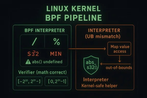

At a high level, the bug arises because the interpreter and verifier are doing two different things wite verifier’s abstract interpretation logic, specifically the
The kernel description makes the exploitation concern explicit: the mismatch can be exploited for out-of-bounds map value aclly important because BPF maps are foundational to a huge amount of kernel and userspace coordination. If a malicious or carefully crafted program can reach an out-of-bounds map access path, the impact can range from denial of service to information disclosure to privilege escalation, depending on the surrounding conditions and kernel hardening. The CVE record itself focuses on the undefined behavior and the mismatch, while the security implication comes from how BPF uses map access as part of its normal execution model.

S32_MIN and relies on an abs() macro that is explicitly undefined for that value. That mismatch between the interpreter and the verifier can lead to out-of-bounds map value access, which is exactly the sort of boundary-condition defect that kernel attackers and defenders both care about. The fix is small, surgical, and telling: add a safe abs_s32() helper and replace the eight affected call sites in the interpreter. has become one of the most important programmable subsystems in the Linux kernel. It powers observability, networking policy, packet filtering, tracing, and a growing number of security-sensitive workloads. That popularity is also what makes BPF bugs worth close attention: a flaw in the interpreter or verifier can have impact far beyond a single subsystem because BPF is often used as a privileged, high-trust execution environment. In practice, mistakes in BPF arithmetic or bounds tracking tend to be treated as kernel security issues first and implementation quirks second.The newly published CVE describes a very specific failure mode. The interpreter’s signed 32-bit division and modulo handlers use the kernel
abs() macro on s32 operands, but that macro is undefined for the minimum representable signed 32-bit value. When the destination register contains S32_MIN, the result can remain negative after abs() and then be sign-extended into a u64 in a way that breaks the division logic. The verifier, meanwhile, computes the mathematically correct result for range tracking, so the two code paths diverge. That divergence is the real danger: a verifier/interpreter mismatch can create a false sense of safety and allow out-of-bounds access to map values.This kind of bug maifier is supposed to be the interpreter’s guardrail. If the verifier says a program is safe, the interpreter must execute the same semantics. When the two disagree, the kernel can end up approving a program under one mathematical model and running it under another. That is the kind of inconsistency that has historically underpinned many BPF exploitation chains. The exploit primitive is not the division itself; it is the broken assumption that the verifier and runtime agree.
The upstream fix is elegant. Rather thansue with ad hoc checks, maintainers introduced
abs_s32(), which handles S32_MIN correctly by casting to u32 before negating. That avoids signed overflow entirely. They then replaced all eight abs((s32)...) call sites in the interpreter’s sdiv32 and smod32 handlers, while leaving the 64-bit division and modulo paths untouched because those do not use abs() in the same way.This is also one of those CVEs where the technical wording tehe underlying engineering philosophy. The kernel team did not redesign BPF arithmetic; they corrected a single, well-isolated undefined behavior issue and aligned the interpreter with the verifier. That is the hallmark of a fix that is both backportable and security-relevant.

scalar32_min_max_sdiv range tracking, uses mathematically correct signed division behavior. The interpreter, however, hits undefined behavior when it feeds S32_MIN into the kernel abs() macro. On common platforms such as arm64 and x86, that undefined behavior can leave the value unchanged, which is then misinterpreted downstream. That is not just an arithmetic quirk; it is a semantic split that can be weaponized.The kernel description makes the exploitation concern explicit: the mismatch can be exploited for out-of-bounds map value aclly important because BPF maps are foundational to a huge amount of kernel and userspace coordination. If a malicious or carefully crafted program can reach an out-of-bounds map access path, the impact can range from denial of service to information disclosure to privilege escalation, depending on the surrounding conditions and kernel hardening. The CVE record itself focuses on the undefined behavior and the mismatch, while the security implication comes from how BPF uses map access as part of its normal execution model.
The fix also reveals how kernel developers think about correctness. The maintainers did not introduce a special-case branch only for one architect try to “fix”
do_div() at the end of the pipeline. Instead, they eliminated the root cause by ensuring the absolute-value operation itself is well-defined for the full signed 32-bit domain. That is cleaner, less invasive, and much easier to reason about in stable trees. Kernel fixes that preserve semantics are usually the best fixes.How the Bug Emerged
The root of the problem is theabs() macro documentation in include/linux/math.h, which explicitly warns that the result is undefinede type minimum. That warning is not academic. For two’s-complement signed integers, -INT_MIN cannot be represented in the same signed type, so any implementation that tries to negate it directly risks overflow or implementation-defined behavior. In practice, the BPF interpreter landed right on that edge.When
DST contains S32_MIN (0x80000000), abs((s32)DST) triggers undefined behavior and, on arm64/x86, can return S32_MIN unchanged. The kernel then sign-extends that value into a0xFFFFFFFF80000000. That is a huge difference from the intended positive absolute value, and it corrupts the inputs passed todo_div()`. Once the arithmetic is wrong at that stage, the interpreter’s result no longer matches what the verifier predicted.The significance here is not just “bad math happened.” The significance is that the interpreter and verifier are supposed to be two views of the same execution model. The verifier is the policy engine; the inution engine. If one believes a value is bounded and non-problematic while the other sees a wrapped or sign-extended edge case, the safety guarantee collapses. That mismatch can be especially dangerous in a system like BPF, where the verifier’s approval is what makes the program eligible to run at all. A verifier mismatch is often the real vulnerability, not the low-level bug that caused it.
Another reason this issue is notable is that it is narrowly scoped to signed 32-bit arithmetic. The CVE text explicitly says
s32 is the only affected case, and the signed 64-bit division and modulo handlers do not use abs(). ngs. First, the bug is not a blanket flaw across all BPF arithmetic. Second, the maintainers already had different code paths for different widths, which made the bad assumption easier to isolate and fix.Why S32_MIN Is So Special
S32_MIN is one of those values that quietly punishes sloppy assumptions. It is a perfectly valid integer, but it sits at the exact point where a signed negation overflows. Any code that assumes absolute value is alwntegers is exposed here. The interpreter’s use of abs() on s32 inputs was therefore not merely a style issue; it was a latent correctness flaw waiting for the right input.The kernel fix,
abs_s32(), avoids that trap by converting to u32 before negating. That shifts the computation into an unsigned domain where the arithmetic can be expressed without signed overflow. In other words, the fix does not “force” the right answer by accident;nswer representable. That distinction is what separates a safe fix from a lucky one.S32_MINis the lowest signed 32-bit value.abs()is explicitly undefined there.- The interpreter could preserve the wrong value after sign extension.
- The verifier still tracked the mathematically correct range.
- That difference opened the door to out-of-bounds map access.

Map Access and Exploitability
The CVE record’s reference to out-of-bounds map value access matters because maps are the most common state mechanism in BPF. They are where counters, policies, and scratch data live. If a program can reach beyond a map value boundary, the kernel may expose adjacent data or corrupt internal state, depending on the map type and surrounding protections. That is om “wrong arithmetic” to “security boundary violation.”This also explains why the issue is security-relevant even though it seems narrow. Many kernel bugs become exploitable only when a particular edge value interacts with a trusted helper or storage abstraction. Here, the edge value is
S32_MIN, the trusted abstraction is the BPF interpreter, and the storage boundary is a map value. That combination is exactly the kind of thing exploit developers look for.- The vehematically correct range.
- The interpreter could compute a different runtime value.
- That mismatch can affect map indexing or bounds.
- BPF maps are security-sensitive shared state.
- The issue therefore crosses from correctness into exploitability.

The fix is gratifyingly direct. The kernel introducesabs_s32(), a helper that handles S32_MIN without invoking signed by casting to u32 before negating, which keeps the arithmetic within a well-defined unsigned range. This is the kind of change kernel maintainers like because it corrects the logic at the point of error rather than layering checks around every downstream consumer.The patch also bs((s32)...)
call sites in the interpreter’ssdiv32andsmod32` handlers. That matters because a partial fix would leave inconsistency behind. If only one path were corrected, the interpreter could still expose undefined behavior in another branch, reintroducing the same mismatch under a different execution shape. The explicit replacement of all call sites tells us the maintainers wanted complete closure on the bug class, not a quick patmptom.There is also a nice separation of concerns in the fix. The 64-bit division and modulo handlers are left alone because they are not using the problematic
abs() path. That suggests the issue was not some general flaw in BPF division semantics, but specifically a 32-bit implementation detail with a very constrained blast radius. That kind of clarity is useful for both auditors and downstream vendors.The deeper point is that the fix respects the kernel’s arithmetic model. It does not reinterpretion or modulo, and it does not add artificial guardrails that could distort output for valid values. Instead, it makes the edge case behave like the rest of the domain. That is the difference between remediation and alteration.
Why abs_s32() Is Better Than a Guard
A naive guard like “if value is S32_MIN, return something else” would only disguise the defect. It might prevent undefined behavo leave room for inconsistency and special-case drift. By contrast, abs_s32() is a real mathematical correction: it preserves the absolute-value intent without requiring a signed overflow. That makes the helper reusable and easier to trust across the codebase.A helper-based fix also improves maintainability. Future reviewers can see that thisy to compute a 32-bit absolute value safely in kernel code. That reduces the odds that another developer will reintroduce the same bug in a nearby call site six months later. In kernel security work, making the safe path obvious is almost as important as fixing the bug itself.
abs_s32()avoids signed overflow.- Casting to
u32makes the negation well-defined. - All eight vulnerable interpreter call sites are corrected.
- The 64-bit handlers were .
- The patch is narrow enough to backport cleanly.
