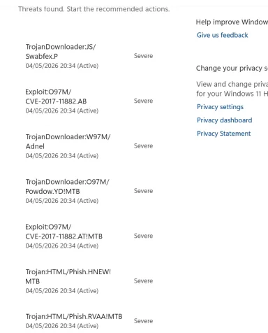

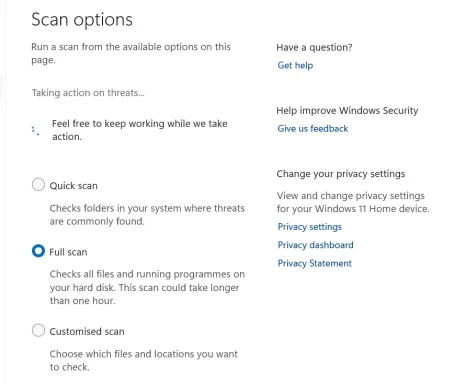

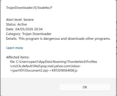

I ran Defender Quick Scan and it worked fine
Then I ran Full Scan. It found a number of problems (see attachment)
But it kept stopping during the process of cleaning and asking to restart (not sure if it mean Defender or the PC)
It did several times,
I investigated online and I found a similar problem related to MalwareBytes. I had it and Unistalled a few days ago
Windows Defender não abre
Could you help, please?
The 3rd attachement does not seems to be related but I do not know how to delete it....

Found it again and id not clean. See attach
Shall I copy the original to Thumbird and delete the email with the virus?
8 aug 24. Easy to find

Yes, Qim — that is the correct next step.
You have now confirmed the bad item is in:
AndorraIN
and ESET identifies it as:
PDF/TrojanDownloader.Agent.BRZ trojan
in the test copy:
C:\ESETTEST\AndorraIN
Since you have narrowed it to 8 August 2024, the clean fix is now to remove that exact email from Thunderbird.
Do this now​
1. Delete the Desktop copy if it still exists​
  • Do not open the .eml file again.
  • Delete the Desktop copy.
  • Empty the Recycle Bin.
2. Restore/open the full original in Thunderbird​
If Thunderbird does not currently show the full AndorraIN, yes — copy the original AndorraIN from the pen drive back into:
C:\Users\open1\AppData\Roaming\Thunderbird\Profiles\cricit3s.default\Mail\pop.gmail-1.com
Copy only the single file:
AndorraIN
Do not copy the whole pop.gmail-1.com folder.
3. Delete the bad email in Thunderbird​
  • Open Thunderbird.
  • Go to [email][email protected][/email] > AndorraIN.
  • Find the email dated 8 August 2024.
  • It appears to be:
FACTUR@544009 - 2345677890
  • Delete that email.
  • Empty Thunderbird Trash.
  • Run:
File > Compact Folders
The Compact Folders step is essential, because Thunderbird may otherwise keep deleted message data inside the AndorraIN mailbox file.
4. Rescan the cleaned mailbox​
  • Close Thunderbird.
  • Delete the current file in:
C:\ESETTEST
  • Copy the updated Thunderbird AndorraIN into:
C:\ESETTEST
  • Scan only:
C:\ESETTEST
with ESET.
Expected result​
If that was the only remaining infected email, ESET should now report:
No threats found
If ESET still detects something, then there is a second infected email in AndorraIN, but your method is now proven and we can repeat it.
Short answer​
Yes: copy the original back into Thunderbird, delete the 8 August 2024 malicious email, empty Trash, compact folders, then rescan C:\ESETTEST.

Excellent, Qim — that ESET log confirms it:
  • Scanned files: 417658
  • Detected files: 0
  • Cleaned files: 0
  • Status: finished
So yes: all clean now.

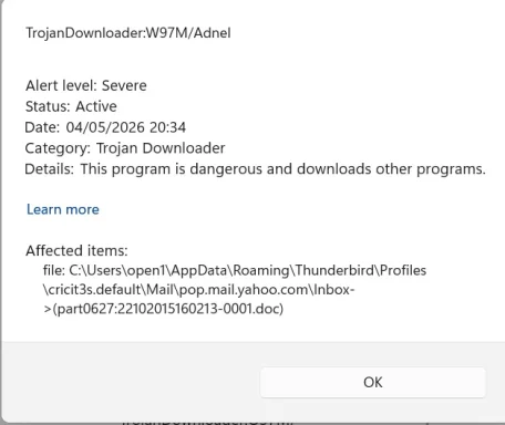

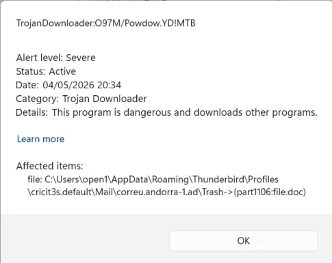

Why Defender did not find them​
There are a few likely reasons.
1. They were inside Thunderbird mailbox files​
Thunderbird stores many emails inside large mailbox files such as:
AndorraIN
Inbox
Trash
These are not normal separate files like:
invoice.pdf
Instead, the malicious PDF/email was buried inside a large mail container. Some antivirus engines inspect those containers more deeply than others.
2. Defender may detect the threat only when extracted or accessed​
Defender often does very well with active threats and files being opened, downloaded, or executed.
But if the bad item is just sitting as an old attachment inside a Thunderbird mailbox archive, Defender may not unpack and inspect it in the same way ESET did.
3. Different antivirus engines have different signatures​
ESET detected it as:
Defender may not use the same name, same signature, or same detection logic. VirusTotal showed not all vendors detected it either, so this was not universally detected by every engine.
4. It was not active malware​
This is important: the threat was stored, not running.
It was an old malicious email attachment inside mail storage. Since you did not open it, it was more like a dangerous item in an archive than an active infection.
Bottom line​
Defender missing it does not necessarily mean Defender failed badly. It means ESET was better at detecting that particular old PDF threat inside Thunderbird mailbox storage.
What I would do now​
  1. Keep Defender active.
  2. Keep Windows updated.
  3. Keep Thunderbird compacted occasionally.
  4. Do not keep old suspicious mail archives on the live PC unless needed.
  5. Keep the USB backup, but remember it may contain old infected mail if it is the original uncleaned copy.
You did very well. This was a complicated Thunderbird mailbox cleanup, and the final ESET result is exactly what we wanted.
