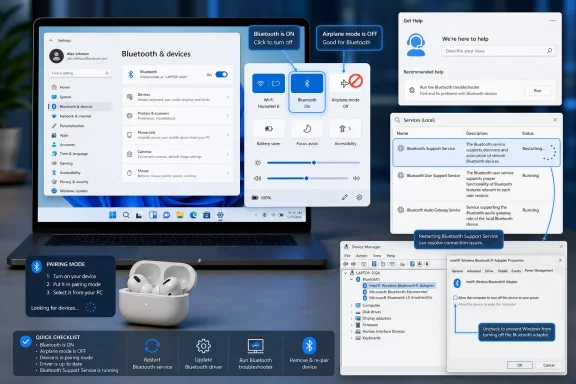

The most useful advice for Windows Bluetooth problems is also the least glamorous: start with the switch. On Windows 11, the Bluetooth tile lives in Quick Settings, reached from the cluster of Network, Sound, and Battery icons on the right side of the taskbar. If Bluetooth is off, Windows may simply behave as if your headphones, mouse, or speaker has vanished.
Airplane mode deserves the same early check. It is easy to toggle accidentally on a laptop, especially on machines with keyboard shortcuts or vendor utilities, and it can disable wireless radios in ways that look like a deeper hardware failure. Before uninstalling drivers or blaming Windows Update, make sure Airplane mode is off and Bluetooth is on.
The same check exists inside Settings. On Windows 11, go to Start > Settings > Bluetooth & devices and confirm that Bluetooth is enabled. On Windows 10, the equivalent path is Start > Settings > Devices, though Windows 10 is now a legacy target for most troubleshooting advice after Microsoft ended general support on October 14, 2025.

The path is Start > Settings > System > Troubleshoot > Other troubleshooters. Find Bluetooth, select Run, and let Windows work through its checks. If the issue is a stuck configuration, a service-level problem, or a common radio state error, the troubleshooter may fix it without touching Device Manager.

Pairing mode matters because Windows cannot pair with a device that is merely turned on. The exact method varies wildly by product: some require holding a power button, others use a dedicated pairing button, and earbuds often require a case-button sequence. If Windows cannot see the device at all, the first question is whether the device is actually discoverable.

Press Windows key + R, type services.msc, and press Enter. In the Services console, find Bluetooth Support Service, right-click it, and choose Restart. Then test the device again before changing anything else.

Device Manager exposes the most direct fix. Open Device Manager, expand Bluetooth, right-click the Bluetooth adapter, choose Properties, and look for the Power Management tab. If the option “Allow the computer to turn off this device to save power” appears, uncheck it and save the change.

Open Device Manager, expand Bluetooth, right-click the adapter, and choose Uninstall device. Restart the PC afterward. Once Windows boots, it should reinstall the Bluetooth adapter and rebuild the relevant driver state.

- Run the Windows 11 Bluetooth troubleshooter through Settings and Get Help because it can repair common faults with little risk.
- Put the accessory in pairing mode, charge it, move it close to the PC, and make sure it is not already connected to another device.
- Remove and re-pair stale Bluetooth devices when they used to work but now fail to connect reliably.
- Restart Bluetooth Support Service and disable adapter power-down behavior if the radio is visible but unstable.
- Update, roll back, or reinstall the Bluetooth adapter driver only after the simpler checks have failed.
