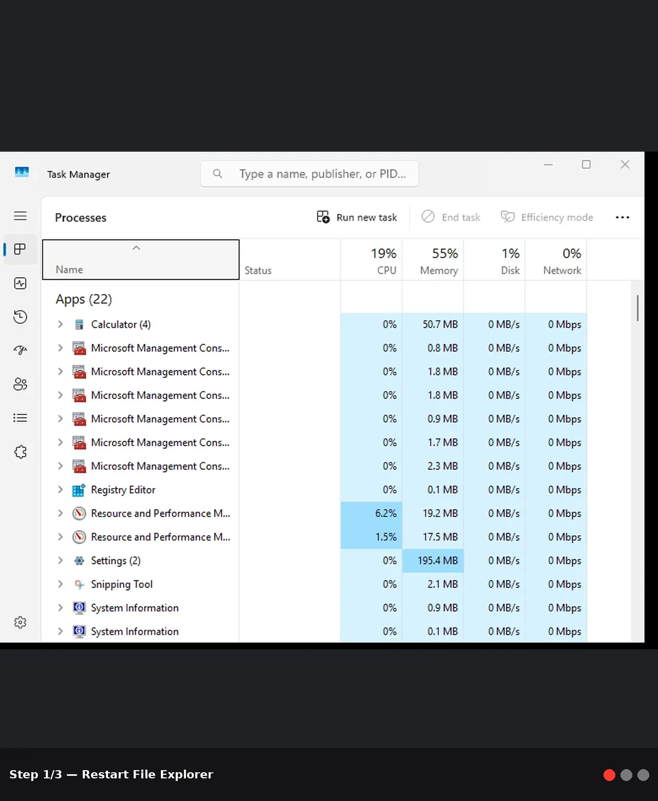

3. Restart File Explorer​
File Explorer controls your desktop, taskbar, folders, and much of the drag-and-drop experience. Restarting it often fixes the issue without rebooting the whole PC.
Windows 11​
  1. Press Ctrl + Shift + Esc to open Task Manager.
  2. If Task Manager opens in compact view, select More details.
  3. Select Processes.
  4. Find Windows Explorer.
  5. Right-click Windows Explorer.
  6. Select Restart.
  7. Wait a few seconds for the taskbar and desktop to reload.
  8. Test drag and drop again.
