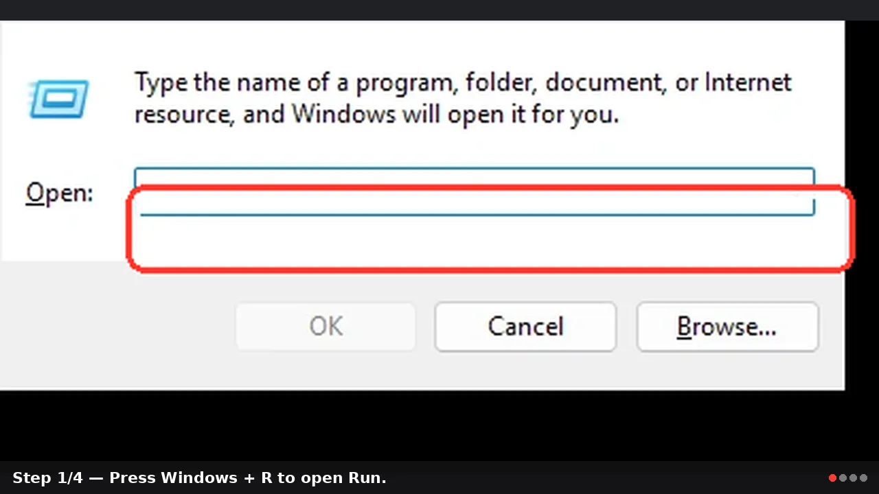

Before changing settings, make sure the network share itself is available.- Press Windows + R to open Run.
- Type the full network path to your share, for example:
\\ServerName\SharedFolder - Click OK.
