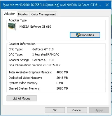

I hate to differ, but no, I have a stock HP Compaq Elite 8300 Small Form Factor CPU cabinet with everything in it absolutely stock. The only thing I changed was the OS, from Windows 8 Professional to Windows 10 Professional. So, no, my graphics card is not "beefed up" in any manner, because its never been tampered or fiddled with, its just there form the beginning. Maybe the attached image will be able to help you in understanding my problem, because the attached screenshot is of the "advanced display properties" window.
Thank you, sincerely,
Rudy'03
Edit: Also, I noticed the "shared memory" option is using up the Graphical power I require. Maybe I could decrease the "shared memory" somehow? So I can allot it all to my games?
I simply meant that another GB of RAM had been added somewhere along in it's design history as the default shows it being a 1GB card. (see link above) I didn't mean that anyone other than the manufacturer had been 'messing with it'.
So what your information panel is saying is that the card carries 2GB of dedicated Vram but also uses 2.20GB of shared memory. This 'shared memory' is taken from your RAM and is usually configurable via the bios.

So..Y'all mean I only have 2GB graphics installed in my rig? Then what does "Total Available Graphics Memory: 4068MB" mean? Does it mean my VRAM+DRAM is 4068MB? Does this picture also say the same?

kemical
Essential Member
Aug 28, 2007
36,176
Your GPU has 2GB of dedicated Vram although it can 'borrow' if needed an extra 2.2GB. This amount can usually be configured either higher or lower via the bios. Each system is slightly different on where the actual setting is but usually your manual (downloadable at the main support page) will tell you.
Solution
