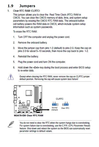

    Try this mate hope it helps
    asus..

    Yeah, I stared at that picture as if it was a map. Problem is, i'm not sure if what i think is the CMOS-thing, is. For a start, in the picture it's 3pins in a row, with 2 pins blow.But what i'm seing is faour pins (in a square shape).
