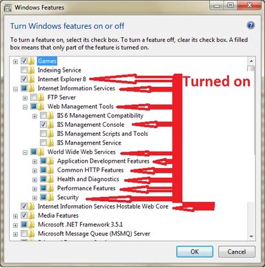

Ok I have finally worked it out, this is what you need to do, you need to go to uninstall a program in the control panel then, turn windows features on or off. Wait for the pop-up to load
Make sure that the following radio buttons are on
Internet Explorer 8 <- used to turn on and off IE8
Internet Information Service
Web Management Compatibility
IIS Management Console
Internet Information Service Hostable Web Core
If the above does not work you should turn off IE8 reboot your system
When your system restarts type run in the start menu then enter inetcpl.cpl in the window and press ok.
When the internet properties comes up go to the advanced tab and restore advanced settings
Then turn IE8 back on in the control panel then reboot and it should work again now
If that does not work you might need to remove all the stored data and temp files
I did all the above steps and deleted anything I could out of the internet program folders so I am not sure which step done it properly but have put them in order of importance
If you pin it down it would be helpful for you to repost the exacting answer
