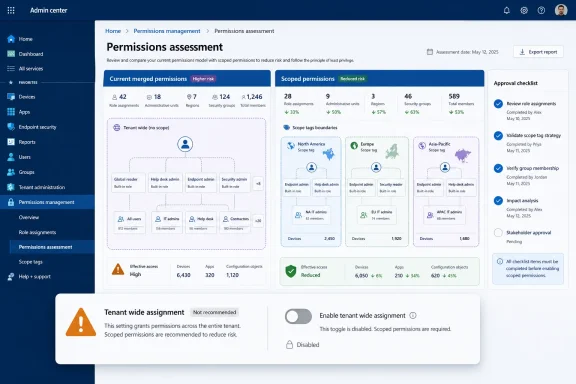

Permissions assessment dashboard compares high-risk tenant-wide access with reduced-risk scoped permissions.Run the Assessment Before Touching the Toggle​
The immediate procedure is straightforward, but the final click carries considerably more weight than the interface suggests:
  1. Open the Microsoft Intune admin center.
  2. Go to Tenant administration > Roles > Settings.
  3. Select Generate Report to run the Permissions Assessment Report.
  4. Compare each administrator’s current effective permissions with the permissions that would remain after Scoped permissions is enabled.
  5. Review the affected roles, security groups, resources, and scope tags with the teams that own those administrative boundaries.
  6. Modify role assignments where the proposed result does not match operational requirements.
  7. Rerun the report and repeat the review until the remaining reductions are understood and accepted.
  8. Leave the Scoped permissions toggle disabled during the pilot.
  9. Enable the toggle only after the organization is ready to adopt the new model tenant-wide.
The report can be generated repeatedly before opt-in, making it the practical center of the pilot. Microsoft says Scoped permissions activation is a one-time action that cannot be undone, so there is no supported path for switching it on briefly, testing production behavior, and rolling back if administrators lose access they still need.
That distinction defines the right pilot. Organizations should pilot the assessment, remediation, and approval process, not the irreversible tenant switch.

Microsoft’s comparison report provides something Intune teams have historically needed: a view of how their written assignments differ from the effective access created by permission merging. Even organizations that do not plan to enable the preview immediately can use that comparison to find administrative boundaries whose enforcement is weaker than expected.
Start with groups showing the widest difference between current and post-enable permissions. Those entries indicate places where administrators rely most heavily on permissions inherited indirectly from another scope-tag context.
The next step is to map each reduction to an operational responsibility. If an administrator is expected to update an object within a particular boundary, that capability should be represented directly in the assignment governing that boundary—not borrowed from a more permissive assignment elsewhere.
This aligns with the broader direction of Intune administration. Recent WindowsForum coverage of Microsoft’s June 2026 Intune update highlighted continuing expansion of the platform’s management and remediation capabilities. As Intune gains more operational reach, ambiguous delegated permissions become more consequential, not less.
The assessment should also be rerun after role changes. Editing one assignment can resolve a reduction while exposing another dependency, particularly where an administrator belongs to several groups. The goal is not to make the report empty at any cost; it is to ensure that every post-enable permission set matches an approved responsibility.
