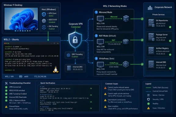

The decision should be based on the actual developer or business task. A connected VPN is not enough evidence by itself. WSL must be able to resolve required internal names and connect to the approved services that users need.

Use the same verification sequence for every mode:

nat, mirrored, virtioproxy, and DNS tunneling. In brief:natis the documented default mode.mirroredmirrors Windows network interfaces into Linux.virtioproxyis an alternate WSL networking mode.nonedisables WSL networking.
