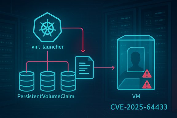

Diagram of a vulnerability chain from virt-launcher to PVC/VM (CVE-2025-64433).Background​
KubeVirt is a widely used extension that brings full virtual machines into Kubernetes clusters. It works by pairing a small per-VM helper pod, the virt-launcher, with libvirt inside that pod to present virtual disks backed by PVCs to the VM. That architecture is powerful because it reuses Kubernetes storage and scheduling while exposing a familiar VM lifecycle to operators.
CVE-2025-64433 targets the interaction between PVC-backed disk mounts and libvirt’s handling of the mounted files. The vulnerability arises when a malicious or misconfigured PVC contains symbolic links that point to files inside the virt-launcher pod’s filesystem. Because libvirt can treat certain host files as block devices during the attachment process, a symlink created inside the PVC can make a host/launcher file appear as a disk inside the VM. Compounding the issue, a second logic/ownership bug results in the target file appearing to belong to the unprivileged runtime user (UID 107) at mount time, bypassing that sandboxing mechanism and enabling the VM to read the file contents. This is a confidentiality breach that crosses the container / VM boundary rather than code-execution or privileged escalation inside the host kernel. The community assigned a moderate score to the issue (CVSS 3.1 base score 6.5) while vendor and project advisories enumerated realistic scenarios and recommended immediate patching.
Technical overview​
What exactly goes wrong?​
  • When a PVC is mounted into the virt-launcher pod, its contents are made available to libvirt to present as block devices to the guest.
  • If an attacker controls the PVC contents, they can create a symbolic link that points to a file elsewhere on the virt-launcher pod’s filesystem (for example, /etc/passwd or VM config files).
  • Libvirt’s device handling may accept that symlinked file and treat it as the backing file for a virtual disk.
  • A second defect changes the ownership of the file to the unprivileged runtime user (UID 107) before the mount, which removes the expected access denial and lets the guest read the file.
  • The result: data from the virt-launcher pod (and potentially other host-attached files reachable via symlink) becomes readable inside the VM.
