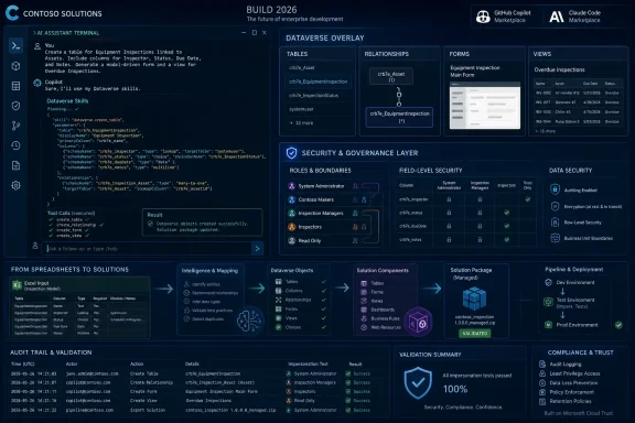

Microsoft used Build 2026 to show a Dataverse plugin for coding agents that lets GitHub Copilot and Claude Code act on enterprise data models, CRM records, and security configuration through natural-language prompts in a terminal, with availability now through the Claude and GitHub Copilot marketplaces. The demo matters because it reframes Dataverse not as another low-code back end waiting for a maker, but as a business platform that can be manipulated by an agent with enough guardrails to avoid the usual hallucination trap. Microsoft is not merely promising that AI can write code faster; it is arguing that AI can safely perform the messy middle of enterprise application work. That is a much bigger claim, and one IT departments should examine carefully.
The most interesting part of Microsoft’s Dataverse plugin announcement is not that an agent can create a table. We have been watching AI tools scaffold code, generate schemas, and spit out plausible configuration for years now. The leap here is that Microsoft wants the agent to operate directly inside Dataverse with awareness of solutions, relationships, forms, views, users, business units, field-level security, and deployment packaging.
That distinction matters. A general-purpose coding agent can guess at a schema from a prompt, but it does not inherently know the difference between a lookup, a many-to-many relationship, a choice column, a security role, or a component that must be explicitly added to a solution. In a consumer toy app, those mistakes are annoying. In a production Dataverse environment, they are the difference between a useful business system and a compliance incident wearing a friendly Copilot glow.
Microsoft’s thesis is that domain tooling is what turns an agent from an autocomplete engine into an enterprise operator. The plugin gives the agent a controlled vocabulary and a set of tools for acting on Dataverse objects. That is the same architectural direction Microsoft has been pushing elsewhere with MCP servers, Copilot extensions, and Power Platform governance: the agent should not simply be smarter; it should be better connected to the system of record.

- Teams should require agent-created work to be packaged in solutions so it can be versioned, reviewed, moved, and retired like any other platform asset.
- Write-back scenarios should include confirmation, ambiguity handling, and audit review, especially when notes, activities, owners, security roles, or sensitive fields are involved.
- Security configuration should be paired with validation evidence, because role creation without tested access outcomes is only half the job.
- Business users should understand that natural-language prompts reduce syntax friction, but they do not remove responsibility for intent, data quality, or policy compliance.
