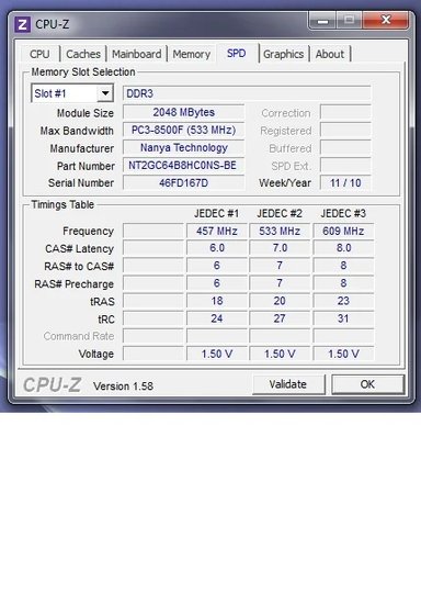

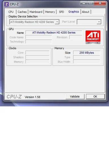

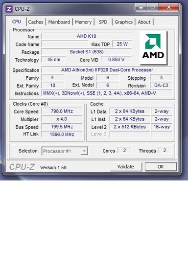

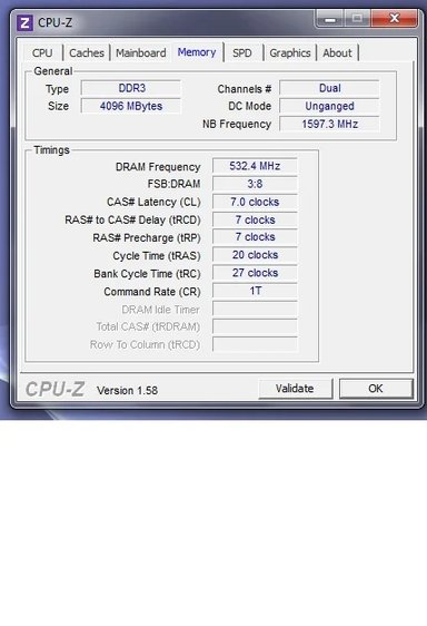

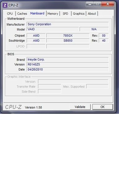

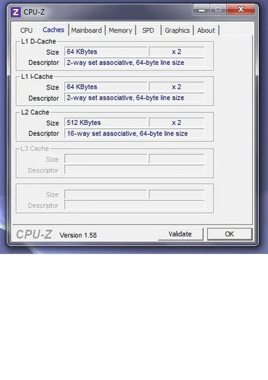

Hi Elmer,
As you mentioned my Laptop settings in my user profile. Its not complete because I don't know how to get some parameters of my laptop. I used CPU-Z to find my laptop internal details and fill up my user profile. I have attached CPU-Z reports as well. Also I have attached the updated driver list. Pls have a look at it and if possible, mention the outdated drivers because I am kind of having a tough time determining whether or not my drivers are up to date. Most of the driver update softwares appear inaccurate and fake. That's the problem.

Hi,
When looking at your spec's and noticed your 50c at Idle and 68c during load. This is a little on the high side. AMD recommend 50C full load 100% both cores. Can you check to see if any of the cooling vent's are blocked. Could you get wprime . Run the 1024M test and monitor your temps post them back here please can see if your overheatiing.

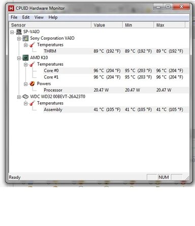

Hi nmsuk, thanks for giving gprime.exe...Atleast it helped me to figure out that my core is heating up too much. I followed your instructions. I pressed shift. Then the app started executing a bunch of threads. And I started monitoring my cpu and other temperatures through CPUID hD monitor. Initially the steady state temperature of the core was 55 degree celcius (131 degree Farenheit) and in the midst of gprime run, the temperature rose up to 95 degrees (203 degree farenheit). And Whoa!! I have never seen my core temperature so hot before. All the other temperatures were also pretty high. So does this point to something?

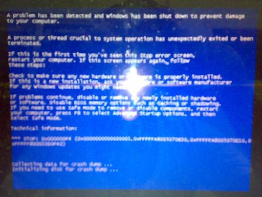

Here are the screenshots that I took while I ran wprime. The core was absolutely flaming hot. And when the temperature got to around 99 degrees celcius, the screen froze and I got the usual bsod with the error code 0X00000F4. I have enclosed that screenshot as well. And followed by that, I got the operating system not found error on the black screen as always. Then that gets rectified once I power off and on a couple of times. That's the story so far.
And yes I forgot to add something. The gprime took quite a lot of time to complete. It was not quick by any means.

#33
Wprime is definately not quick, did confirm a cooling problem though. If your comfortable with taking the laptop apart you could check to see if the fans ok. If your not or it's still under warranty take in to be serviced.
