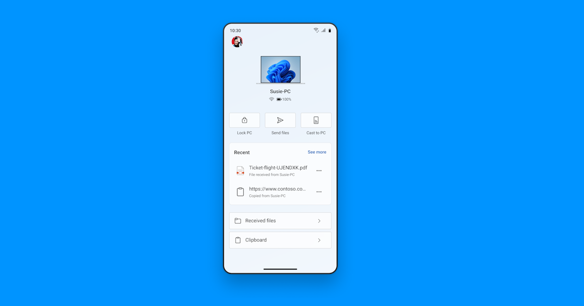

Phone Link: Turn It Off If the PC Does Not Need Your Phone
Phone Link is useful when the PC is meant to act as a phone companion. It can bring phone-related activity into Windows, depending on the device, setup, and permissions. For some users, that is convenient. For others, it turns a quiet desktop into another notification surface.The MakeUseOf writer’s objection was practical: the phone was already nearby. They did not need the PC handling mobile interruptions too.
The setting path in the report is direct: Settings -> Bluetooth & devices -> Mobile devices, then turn off Allow this PC to access content and capabilities from your mobile phone. If a phone is already linked, the cleaner route is inside Phone Link itself: Phone Link -> Settings -> Mobile devices -> Manage devices, then remove the device.
This is not only a performance choice. It is also an attention and privacy choice. If you want texts, calls, photos, and notifications on the PC, Phone Link may be worth keeping. If you do not, leaving the device connected “just in case” adds complexity without a clear benefit.
The best rule is simple: either use Phone Link intentionally or disconnect it. A half-configured phone bridge is rarely the best state.

Previewing a refreshed Link to Windows experience for Android phones
Hello Windows Insiders, We’re excited to begin rolling out an update for the Link to Windows app that includes a refreshed experience for Windows Insiders. This update brings a modernized design, smarter onboarding, and new ways tblogs.windows.com - Official source: support.microsoft.com
