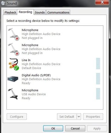

I wish that were the case. I've attached a .JPG of my Record box.
What I have configured is a simple system with Line-in, Line-out and Mic. Before the reinstall there were many more inputs & outputs (too many !) as well as Stereo-mix.
As far as dealing with external and system sounds, that's fine, but I need the stereo mixer/what-you-hear too.

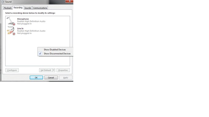

Well, it seems a little strange that something which should be fairly normal isn't working. So I have attached another picture to show the settings to uncover the Stereo Mix, which you have already tried.
Other than that, you do show a Realtek Audio controller in the Control Panel?
And the only other this is the Digital Input you are showing. Just wondering if it might be like HDMI where certain types of recording are not allowed.. Maybe disconnect that to see if anything changes..
