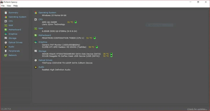

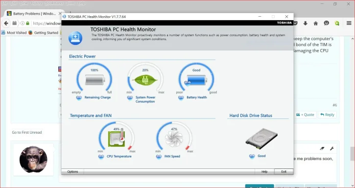

Wow! Thanks for that! I learned a lot! I have a Toshiba lap top going on 5 years. It has never ran hot. I'm expecting it to cause me problems soon, but until it does, I'll just keep chugging along. I had never heard all this before and I'm amazed.
Thank you!
I have never seen it run hotter then this.
Yeah, those are great temps for a notebook and very acceptable for a PC. I don't start to worry about temps until they sit above 60°C for more than a couple seconds. When that happens, that tells me it is time to clean out the dust.
