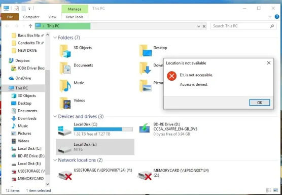

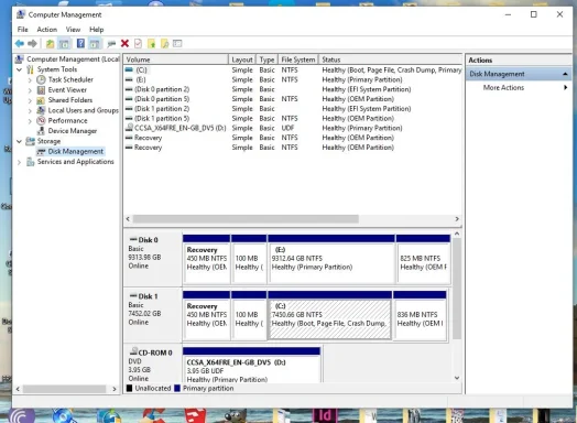

When i tried to load my new harddrive this morning , it was on ages with the windows 10 logo flashing on and off . Before the computer turned itself off . I'm on the old drive at the moment . When i go into settings both drives are listed ,also in Disk Management both drives are shown . ( i thought was it a dodgy sata cable ) . I tried to install windows 10 hoping to be able to install windows on the new hard drive and keep the files and folders . My computer does not let me acess the drive , so somethings wrong . Everything was ok when i logged off last night and shut down . Thank you .

"Access is denied" it's about permissions.
Please follow this tutorial:
livix07 Yes that's what's wrong , the video is too quick for me . Even when trying to pause and take notes . Another link on google which I think has worked
How to Fix Inaccessible Hard Drive - "Access is Denied" Error and Recover Data That's the method I used , which was pretty simple , not to much input to add . I will try the drive tomorrow . Thanks for your help .

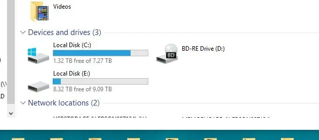

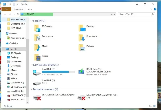

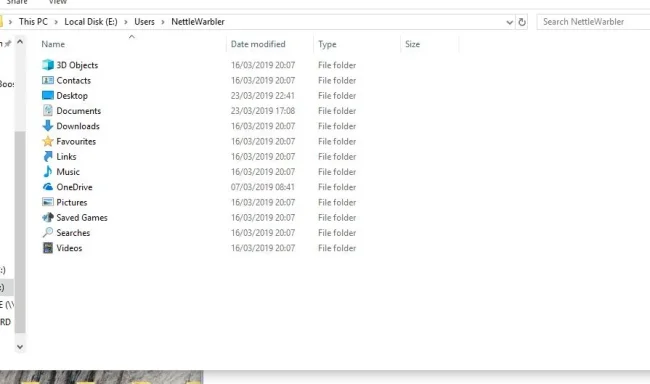

I tried to load my new harddrive earlier i got a BSOD. it was on ages with the windows 10 logo flashing on and off . Before the computer turned itself off . It took about 20 minutes in all , before the PC turned itself off . I was expecting the new drive to be showing not accessible again . But i can still open files from here , i don't know why the BSOD happened and for now i still can't get on the drive itself , I will try later to get online with the new drive .

I still cannot get on the new drive , when I try both drives connected . It ends up with the new drive trying to load first ( even though I put the old drive first in settings ) . I tried to load windows , I put the dvd in the writer went into settings and put start with CD/DVD setting but it just went back to try and load windows . I was going to see if I could install windows and keep the files and folders option .
