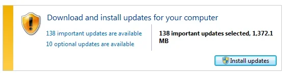

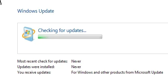

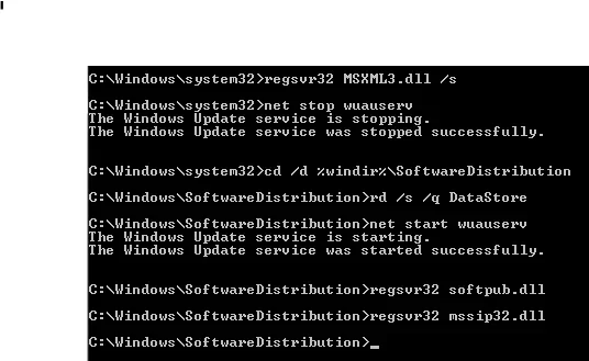

I ran the commands mentioned in the batch file listed above basically re-naming a folder and re-connected to update servers. Connection to both servers was successful. Windows update shows it has never received updates and is checking now so the Update problem is solved. I was also able to receive updates for MSE. [ATTACH type="full" align="right" alt="An image from 'Windows Update Service Is not Running / Possible Error with Startup'. 1. Commands to reset Windows Update components via Command Prompt.
2. Windows Update checking for updates with no prior checks or installs.
3. Notification showing 138 important updates ready to install, totaling 1,372.1 MB.
4. Successful completion of system file scan with no integrity violations found."]27259[/ATTACH][ATTACH type="full" align="right" alt="An image from 'Windows Update Service Is not Running / Possible Error with Startup'. 1. Commands to reset Windows Update components via Command Prompt.

**CONCLUSION**
I may be way off on this, but this is my understanding of what caused the problem. Correct me if I am wrong.
Windows update files were stored on a sector of the HDD which was not accessible due to a hardware failure. Running the following commands through an administrative command prompt created a new folder for windows update files on a working sector of the HDD making them accessible and re-established a connection to update servers.
regsvr32 MSXML3.dll /s
net stop wuauserv
cd /d %windir%\SoftwareDistribution
rd /s /q DataStore
net start wuauserv
regsvr32 softpub.dll
regsvr32 mssip32.dll
After the commands, Windows showed that it had never received any updates or checked for updates because of the new directory which was created.
