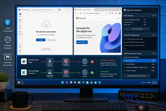

Windows diagnostics show a VPN blocking Microsoft Store internet access while Microsoft Edge connects normally.Establish the scope before changing Windows settings​
First, identify the failure pattern. Open the affected app and note whether it fails immediately, only while signing in, only during downloads, or only on a specific network such as work Wi-Fi, a VPN, hotel Wi-Fi, or a mobile hotspot.
Then test a browser against the same service where practical. For example, if Microsoft Store will not download apps, visit a Microsoft site in the browser; if Outlook cannot synchronize, confirm that Outlook on the web loads. This does not establish that the desktop app’s connection is good, but it distinguishes a broad connectivity outage from an app-specific path problem.
The most revealing split is often this:

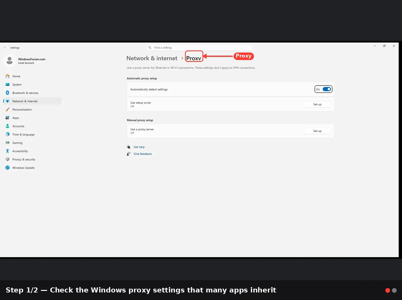

Check the Windows proxy settings that many apps inherit​
Windows 11 Settings on Network & internet > Proxy — automatic and manual proxy setup
Open Settings > Network & internet > Proxy. Windows 10 uses a similar path under Settings > Network & Internet > Proxy.
There are three settings worth inspecting:
  • Automatically detect settings can use WPAD, Windows’ automatic proxy discovery mechanism. It is often enabled on managed networks and does not by itself indicate a fault.
  • Use setup script points Windows to a PAC file, which contains rules telling apps when to use a proxy and when to connect directly.
  • Use a proxy server specifies a manual proxy address and port.
For a personal PC on a normal home network, a manual proxy pointing to 127.0.0.1, localhost, an unfamiliar LAN address, or an old server name is a strong suspect. This is especially common after uninstalling a VPN, proxy client, web-filtering tool, or developer utility that did not clean up after itself. Turn off Use a proxy server, save the change, close and reopen the affected app, and test again.
Treat a PAC script more carefully. A bad or unreachable script can direct some destinations to a proxy that no longer exists, while other destinations continue to work normally. If this is a personal device and you never configured a script, turn off Use setup script and test. If the device belongs to an employer or school, record the script address and stop there; it is configuration evidence for the administrator, not something to casually delete.
Microsoft’s Windows proxy documentation makes an important distinction that routine browser testing hides: applications do not all have to obtain proxy settings through the same mechanism. An app can use its own configuration, the user-level Windows proxy settings, or the WinHTTP configuration discussed below. That is why the browser can be fine while the Store or another Windows-integrated client cannot connect.
