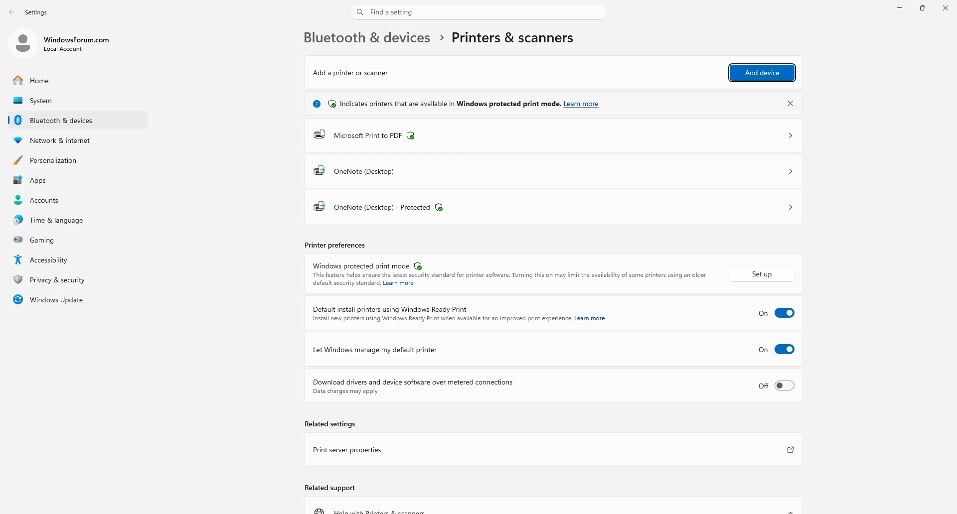

- Windows 11: Settings > Bluetooth & devices > Printers & scanners > select the printer > Open print queue.
- Windows 10: Settings > Devices > Printers & scanners > select the printer > Open queue.
Right-click an unwanted job and select Cancel. Canceling a job is not a backup of it; retain the original document if you might need to print it later. These queue paths and cancellation steps are documented by Microsoft.
Windows 11
- Open Settings > Bluetooth & devices > Printers & scanners.
- Select the retired printer.
- Select Remove.
- Confirm removal if prompted.

3. Open Print Server Properties
You can open the driver-management dialog through Settings or use its direct shortcut.
Open it through Settings
- Go to the printer settings page:
- Windows 11: Settings > Bluetooth & devices > Printers & scanners.
- Windows 10: Settings > Devices > Printers & scanners.
- Under Related settings, select Print server properties. Microsoft’s Windows 11 instructions also refer to the link as Printer server properties.
- Select the Drivers tab.
