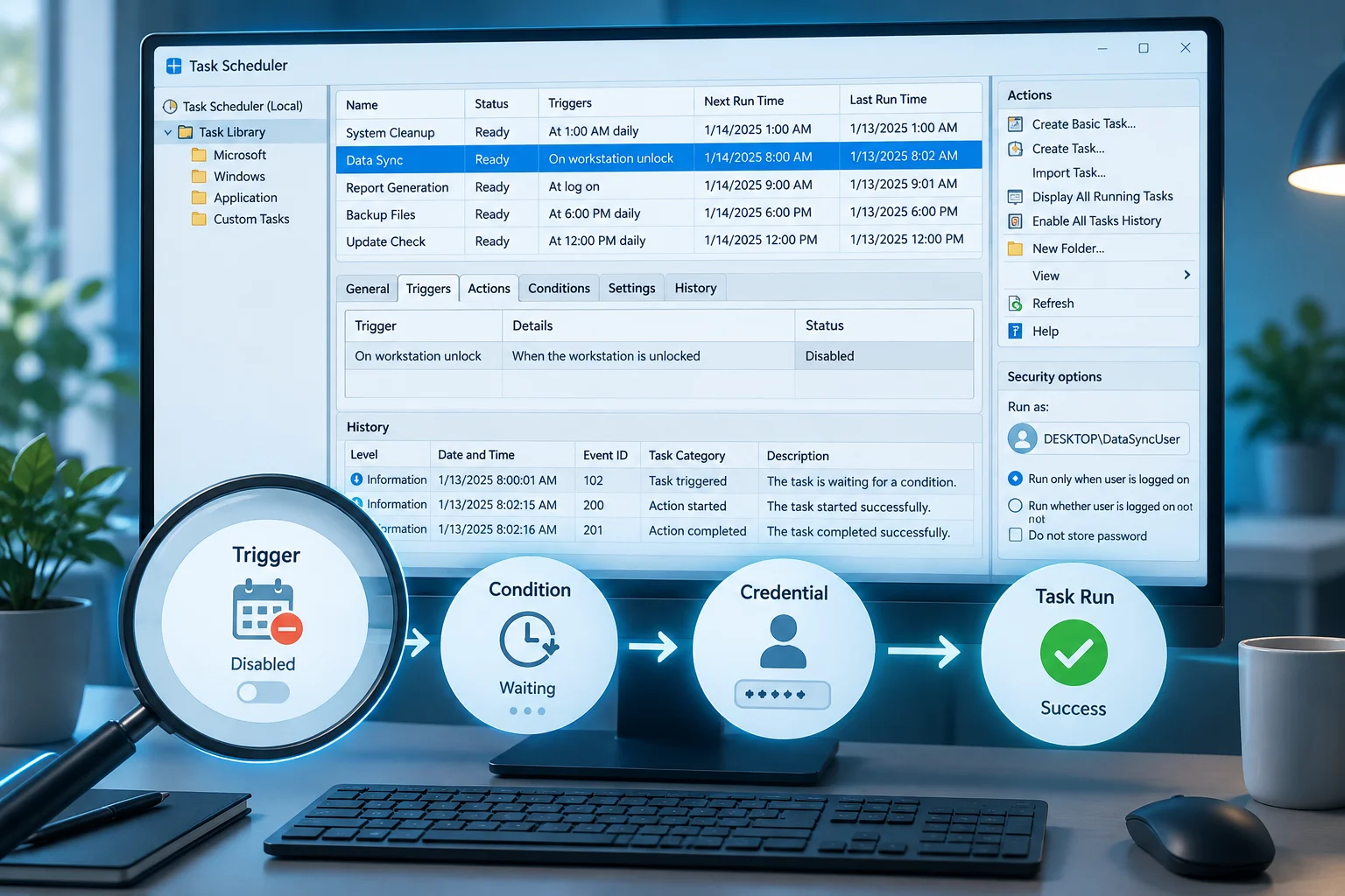

A Windows Task Scheduler screen highlights a data sync task, with an infographic showing its trigger disabled and run status successful. 1. Check the task’s history and result​
