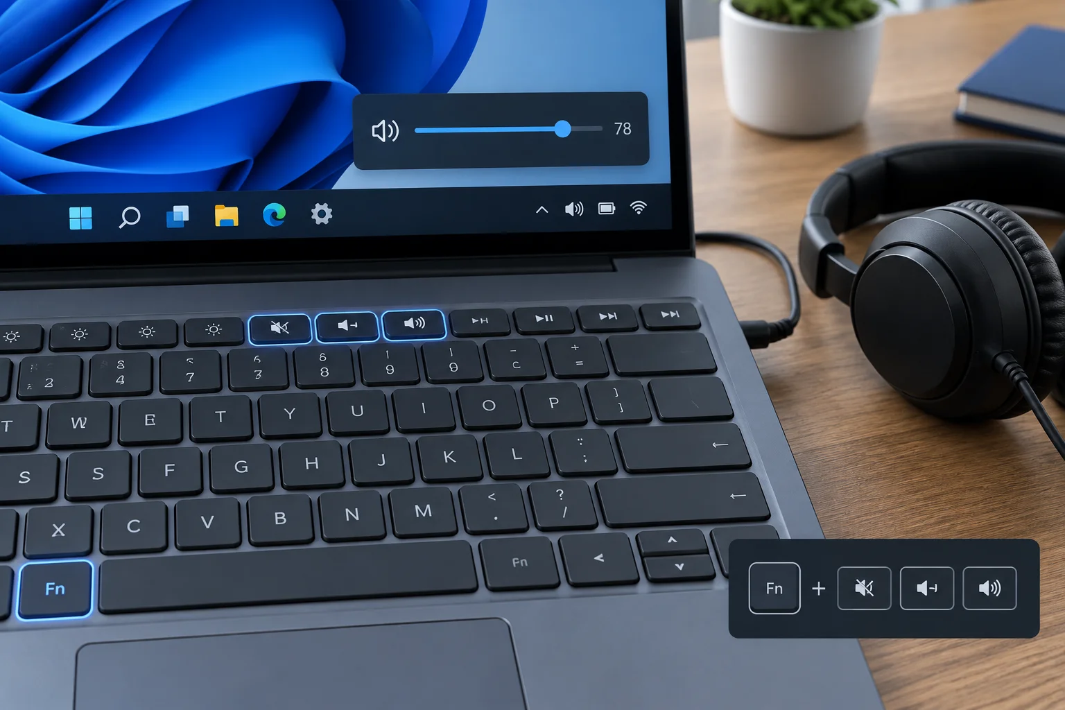

Check Fn mode, F Lock, and the keyboard’s top-row behavior
On many laptops, the volume symbols share keys with F1 through F12. Whether those keys control media or act as standard function keys depends on the laptop firmware and keyboard mode.
- Look at the key that has the volume, mute, or speaker symbol.
- Press the key by itself and watch for the Windows volume indicator.
- If nothing happens, hold Fn and press the same key.
- Repeat for volume down, volume up, and mute.
If Fn + volume key works but the volume key alone does not, the keyboard is currently prioritizing standard F-key commands. This is not a Windows audio-driver failure.
Check for a dedicated key or indicator that changes top-row behavior:
- Some keyboards have an Fn Lock key, an F Lock key, or a lock symbol.
- Some models toggle Fn Lock by holding Fn and pressing another key, commonly Esc, but the exact combination is model-specific.
- On Microsoft keyboards with an F Lock key, the key switches between standard F-key commands and alternate commands.
- On some Surface keyboards, pressing Fn changes whether the top row behaves as special keys or traditional function keys. An indicator light can show the current state.
Do not assume that a shortcut used by a different laptop brand will work on yours. Check the documentation printed on the keyboard, your PC maker’s support page for the exact model, or its installed device-control application.
