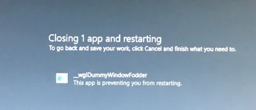

Sometimes when i shut down / restart my computer, this process _wgldummywindowfodder is preventing windows from shutting down. Yes i can press the end task button but i'm wondering what is this, virus scans shows nothing. And there is no such process in the process list..

Sorry guys, there was a slight mistake, its _wgldummywindowfodder not _wgldummyfodder.

After extensive testing, i found the source to come from Memu.
Everytime when i shutdown or restart my computer, This popup will appear '_wgldummywindowfodder is preventing windows from shutting down'. This happens only when i shutdown or restart with Memu(with multiple instance) opened in the background.
I guess im heading to the Memu forum. Thanks for the help guys.
