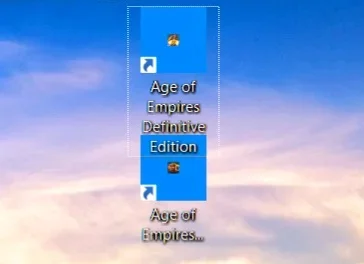

Hello, guys!
Does anyone have any idea why the desktop icons are displayed like this? It’s been like this for a while now and it's incredibly frustrating. I have a couple of games on my computer, but it only happens to Age of Empires (l & ll) and to Europa Universalis lV, which I downloaded from the Xbox app. It wasn't like this from the beginning, it changed only a few months ago and I don't seem to find a solution. Any ideas on how to fix this?

I have part one and 2 and 3 all editions, but the icons are normal.
You have 3 options to solve it.
1- Try the tool in the below link.
2- Recreate the shortcut.
3- Right click on the icon and go to properties then change icon. You can either download the icon file by searching for it. It must be a .ico file. If it is an image then you can use the below link to convert it to .ico. Or you can navigate to the game exe file and select it. Then it will use the same icon for the shortcut.

If they are old games, they may not support larger icons, or the thumbnail cache may be corrupted and needs to be rebuilt

The games are new, both are the Definitive Edition. Same for Europa Universalis, it's the newest game.
Can you please tell me what means to rebuild them and how I can do that?

From a Powershell prompt, run the following to rebuild the icon and thumbnail caches.

Burgundian5000

Tried it, deleted the icon cache then restarted Windows Explorer. Doesn't work, same result. Any other ideas how this could be fixed?

If there is a repair option you can run that to reinstall. A repair will not impact activation or existing content.

It worked! I can't believe it. Finally, after all this time. Can't thank you enough. I used the last option, downloaded the image, converted it then uploaded and it's perfect.

Make sure to not move the new ICO file that you created. It will always be linked to the shortcut.

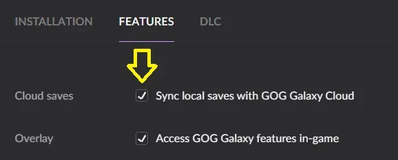

ussnorway
Windows Forum Team
May 22, 2012
4,600
Can you or any of the guys here please help me with something else related to a game? I have the Heroes of Might and Magic 3 from GoG. The problem is that whenever I click on it, it opens the GoG window, I press play, get Syncing 0%, then a sound like an error and the game doesn't start. I don't get it, I contacted the guys from the website and they told me that it should work.
Gog Galaxy needs internet access to sync
1st option is allow that and 2nd option is tell it not to sync

Burgundian5000
New Member
Nov 18, 2022
9

Burgundian5000
New Member
Nov 18, 2022
9
Thank you!
I tried what you told me but it didn't work. What I did notice is that the Overlay box isn't ticked off on my version and there's no way I can do it. Could the problem be there? And is there a way to change that?
ussnorway
Windows Forum Team
May 22, 2012
4,600
M&M3 doesn't have an overlay its too old but the game should sync unless the folder is locked somehow
open the show folder tab and tell us if you have a games folder in there + what address you installed the game too... also lets be clear, you installed the Galaxy build not the off line installer?
