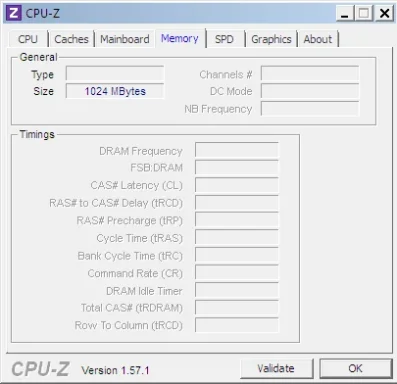

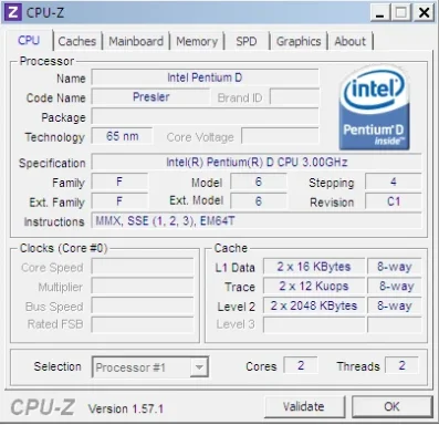

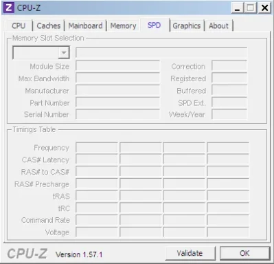

Please make sure your system is configured to accumulate .dmp files. Follow this link by member "ickymay"
http://windows7forums.com/blue-screen-death-bsod/38837-how-ask-help-bsod-problem.html#post140795
Read the other stickies at the Link Removed due to 404 Error regarding acquiring screen shots of your memory using CPU-z and RamMon (save and upload the html file). As well as Captain Jacks SF Diagnotic Tool, be sure to run that as administrator.

- attach CPUZ memory and CPU tab snips
