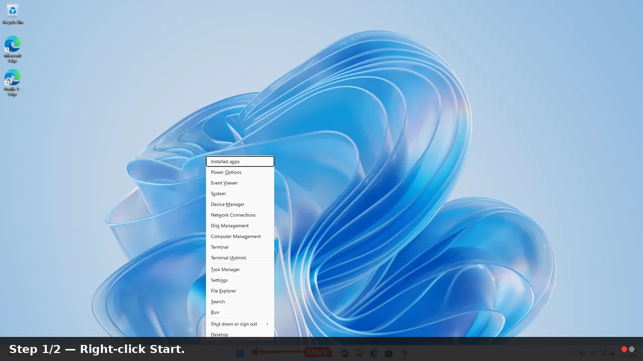

DISM can export all third-party driver packages from the currently running Windows installation.- Right-click Start.
- Select Terminal (Admin), Windows PowerShell (Admin), or Command Prompt (Admin).
- If prompted by User Account Control, select Yes.
