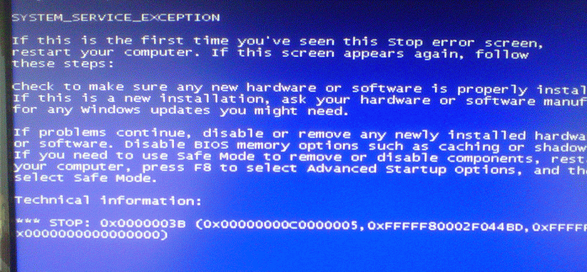

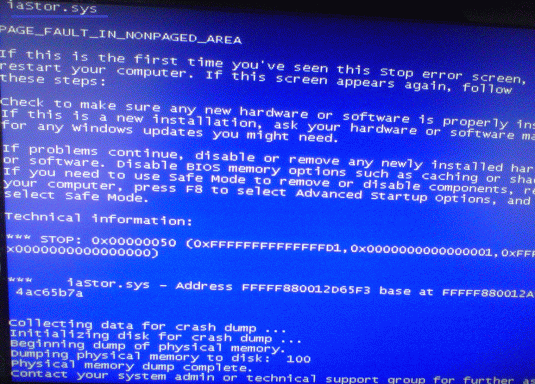

Hello,
After downloading a possible virus, malware etc.-- from keygenguru.com -- , the system crashed and windows didnt load successfully ever after.
I'm getting a 0x70860002 error with blue screen when tried to boot with safe mode.
I can't get any dump as I can't have any access to files.
<< edited I managed to get th dump files >>View attachment dumpfiles.zipView attachment dumpfiles.zip Untitled2.gifUntitled.gif
I tried to recover the PC to an earlier time but it didnt help either.
I'm using Windows 7 Professional edition.

Seems like iaStor.sys caused the System to crash. it's Intel Matrix Storage Manager driver go to Link Removed due to 404 Errorthen see if that works. if not go to C:\Windows\System32\Drivers and rename the iaStor.sys ot iaStor.old and reboot the System.
Then SFC /SCANNOW Command - System File Checker - Windows 7 Forums
