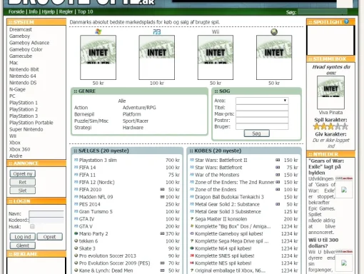

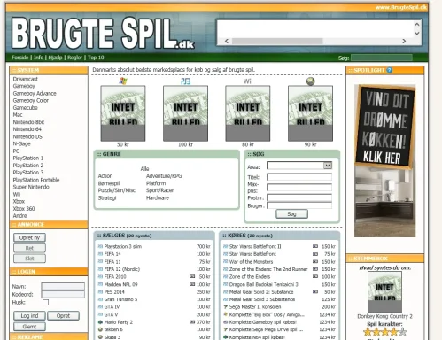

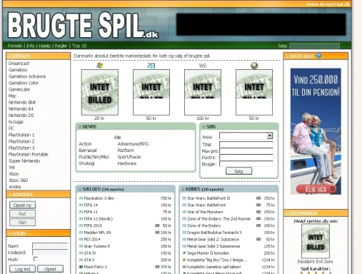

  5. Psycrow
    Psycrow Well-Known Member
    Joined:
    Jul 19, 2011
    Messages:
    39
    Likes Received:
    0
    Ok i will provide screenshots tomorrow when i have the time..later until now
    #5 Psycrow, Oct 22, 2014
  6. Psycrow
    Joined:
    Jul 19, 2011
    Messages:
    39
    Likes Received:
    0
    Here are 3 screenshots from each browser, but you must download or save em to ur pc and open em each with paint to see what i truely see or else you just get blurry on em all
  7. Pauli
    Pauli Extraordinary Member
    Premium Supporter
    Joined:
    Mar 1, 2012
    Messages:
    2,499
    Likes Received:
    211
    FF seems to be clearly the best, although there is the fact that the text is smaller, which enhances sharpness. IE11 is the worst, definitely, while Chrome is in between.
    I wouldn't still glorify or condemn any of them. Monitor settings, calibration viz. perhaps that of contrast, or perhaps a software might well bring a result that satisfies you. Don't have any links to give.
    Perfectionism is not new to me, I'm a photographer by profession.
  8. Psycrow
    Joined:
    Jul 19, 2011
    Messages:
    39
    Likes Received:
    0
    Yes exactly..you can also see Ff is best and IE worst end crome between..
