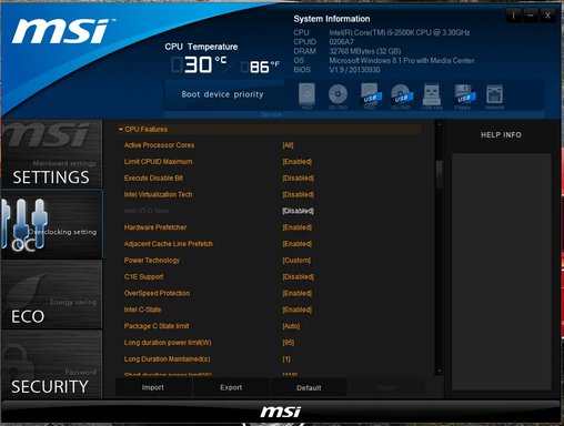

I am having a problem with my boot manager being disabled when I turn my computer on in the morning. The last two mornings I have had to go into my bios and enable it.
Is there some setting I need to change?
My Motherboard is an MSI B75MA-P45
I am running in UEFI mode.

I would first guess for some reason the system is not seeing the Hard Drive when you boot and therefore removing it from the boot options. I am assuming when you say turn your computer on, it is a cold boot and may not be a problem during a restart or wake from sleep.
If there is a bios upgrade, you might try that. You also might disable the full screen logo to see if any messages are showing up that would help solve the problem. There is a possibility the situation involves the hard drive itself and its condition. I have seen threads from some folks running SSDs where they were having this type of problem.
You bios is different from mine in that it the way it annotates the Windows Boot Manager. But you screen shot shows the first boot device as HDD from what I can tell. Is that the Windows Boot Manager option?
Can you disable any of the 9 UEFI boot options?
And I can't see what you have set for the UEFI HDD priorities. So I will assume the boot device is set first.

Yes, the Windows Boot Manager is the option.
I am running a WD HDD 1TB drive.
I will disable the full screen logo and see what messages come up.

Disabled full screen logo, but it didn't stay up long enough to see all. What I could tell it didn't show anything out of the ordinary.
Sonny
Fantastic Member
Nov 17, 2009
1,387
Yes it is a cold boot. I have checked and I do have the latest bios update. The boot device is set first. I will call MSI and see what they say. I hope it isn't my HDD going bad.

Hi davehc, the only boot option I went and disabled was my floppy disc. I don't have one. Should I disable more of the other options also.

All my boot priorities are UEFI. That is what my OS is formatted too. I don't see any other options but UEFI.

On the boot dialog I would look to see if the hard drive showed up as being recognized. It does go by fairly fast, so unless you can use an ESC key to slow it down, you may not be able to tell.
You may try re-seating your hard drive connections to see if it helps.
The reason I asked if you could disable any of the other boot options is I thought there may be a possibility of something confusing the system. If you have any external devices you might try disconnecting those.

You might also try turning off the Windows 8 fast startup to see if it helps.

Thanks Saltgrass, I will do what you mentioned and see what happens in the morning when I boot up. I did disable some of my options like you asked.

After disabling the floppy boot option, my computer booted up fine this morning. I will give it a few more days and see what happens. I think you were right Saltgrass, might have been a conflict there.

Disabling the options didn't work. Just booted up after being off most of the day. Had to go in and enable my windows boot manager again.

I am still thinking your system is not seeing the hard drive early in the boot process and is removing it from the options. But I have no other suggestionsfor a fix except change the hard drive, or perhaps put it on another SATA port, or reinstall those drivers.

I have already switched SATA ports. I think your suggestion about getting a different hard drive is what I am going to do. I was leaning that direction myself.

Problem solved. After replacing the hard drive I still had problems. Finally I made some adjustments in my bios. On my Limit CPUID Maximum I had to enable it. It was disabled my default. I also had to disable Execute Disable Bit and disable Intel Virtualization Tech. That has solved the problem. Been working great for over two weeks now. I don't know about other MB's but this worked on my MSI Board.
