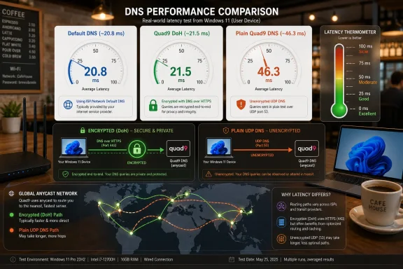

A café Wi-Fi test comparing the network’s default DNS, Quad9 over plain DNS, and Quad9 over DNS-over-HTTPS found encrypted Quad9 lookups averaging about 21.5 milliseconds, nearly matching the café resolver and beating plain Quad9 DNS at roughly 46.3 milliseconds in that session. That result does not prove DoH is universally faster than old-fashioned DNS. It does, however, puncture the lazy assumption that encryption automatically means a meaningful performance penalty. The real story is less about cryptography slowing things down and more about how modern networks reward persistent, well-routed connections.

The more interesting number is plain Quad9 DNS at roughly 46.3 milliseconds. That is not catastrophic; DNS lookups measured in tens of milliseconds are still quick. But it is enough to challenge the reflexive claim that plain DNS must be the fastest option simply because it has fewer protocol layers.
A local or ISP-provided resolver often has a geography advantage. It may sit closer on the provider’s network, benefit from local caching, or travel over a shorter route than a public resolver. That explains why the café DNS performing well is not shocking. What is shocking is that encrypted Quad9 essentially caught it while unencrypted Quad9 lagged behind.
That gap suggests the deciding factor was not “encryption versus no encryption.” It was the path, session behavior, and resolver handling around the query.

The Café Resolver Won, But Only Barely
The café’s default DNS averaged about 20.8 milliseconds across the tested domains. Quad9 with DoH averaged about 21.5 milliseconds. In practical browsing terms, that difference is invisible.The more interesting number is plain Quad9 DNS at roughly 46.3 milliseconds. That is not catastrophic; DNS lookups measured in tens of milliseconds are still quick. But it is enough to challenge the reflexive claim that plain DNS must be the fastest option simply because it has fewer protocol layers.

The PowerShell test usedResolve-DnsName and Measure-Command across Google, BBC, Reddit, Amazon, and GitHub, then averaged the results. Clearing the DNS client cache before testing is important because cached answers can make DNS appear absurdly fast while measuring almost nothing.Even then, this kind of test has limits. Five domains and five runs can reveal a pattern, but they cannot establish a general law. DNS responses may be cached by the resolver, domains may have different record complexity, and the first lookup after changing settings may behave differently from subsequent lookups.

The most concrete lesson from this test is not that everyone should copy the exact settings and expect the same numbers. It is that assumptions about DNS performance are now suspect. Encrypted DNS has matured enough that the old penalty may be negligible, nonexistent, or occasionally reversed.- Encrypted DNS should not be dismissed as automatically slower, because connection reuse and resolver routing can make DoH highly competitive.
- A nearby ISP or venue resolver can still be extremely fast, but speed alone does not make it the best privacy or security choice.
- Quad9’s encrypted result in this test suggests resolver path and session behavior mattered more than encryption overhead.
