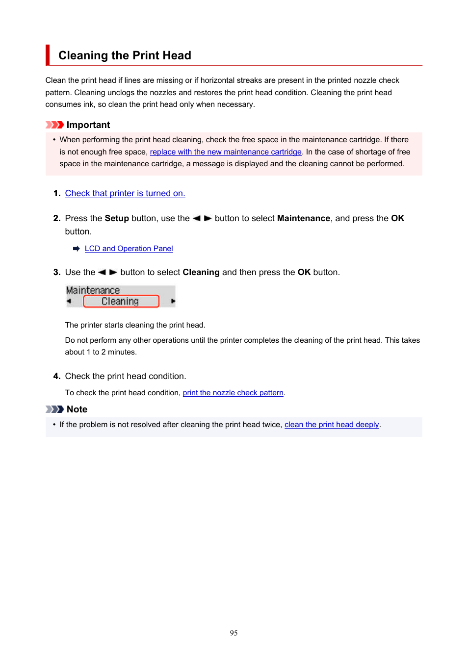

Load plain Letter or A4 paper, then use the printer’s maintenance menu to run a nozzle check. If the pattern shows missing lines, gaps, or streaks, run Cleaning. If the pattern improves but does not fully recover, run Deep Cleaning.
Ink Flush is the heavy artillery. Canon documents it for cases where cleaning and deep cleaning do not restore normal output, especially after prolonged disuse. It can consume a large amount of ink, so it belongs near the end of the maintenance path, not at the beginning.
