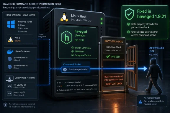

CVE-2026-41054 is a local privilege-escalation flaw in the Linux haveged entropy daemon, disclosed and fixed in haveged 1.9.21 on May 19–20, 2026, in which a failed root-only command-socket permission check still allowed unprivileged users to reach privileged daemon commands. The bug is not a remote wormable catastrophe, but it is the kind of small control-flow mistake that turns a low-privilege foothold into a root problem. For WindowsForum readers, the lesson is not that Linux entropy daemons are suddenly exotic malware magnets; it is that mixed Windows-and-Linux estates increasingly inherit Unix daemon risk through WSL, appliances, containers, and cloud images. The boring patch note is doing more work than it first appears.
The vulnerability sits in haveged, a daemon historically used to feed entropy into the Linux random device, especially on systems where early boot or headless workloads could suffer from weak or slow randomness. It is the sort of background service many administrators install once, forget about, and then rediscover only when a scanner lights up.
The reported flaw was in the command socket handling path. The daemon checked the connecting peer’s credentials and recognized when the caller was not root, but after preparing a negative response it did not actually stop processing. Execution continued into the command switch, which meant the “no” was sent without the operational equivalent of closing the door.
That distinction matters. Security checks are not merely predicates; they are control-flow gates. A permission check that detects a violation but fails to exit is often worse than no check at all, because reviewers, packagers, and administrators may assume the boundary exists when the code path has already walked past it.
The public description points to commands such as chroot-related behavior and command-socket closure as reachable by a local unprivileged user. That puts the bug in a familiar class: not remote code execution from the internet, but local privilege escalation against a daemon already running with root authority.

The Chroot Detail Is a Warning About “Administrative” Commands
The reported impact includes the ability for a local unprivileged user to force daemon behavior involving chroot to an attacker-controlled directory or to close the daemon’s command socket. That may sound narrower than “execute arbitrary command as root,” but administrative control channels rarely need to expose a shell to be dangerous.A privileged daemon command can have side effects that reshape the environment around it. Chroot changes filesystem perspective. Socket closure changes manageability and availability. Even when individual commands appear constrained, their security model depends on the assumption that only trusted callers can invoke them.
That assumption is exactly what CVE-2026-41054 broke. Once an untrusted local user can reach commands intended for root, defenders must analyze the command set as an attack surface rather than a management feature.
This is a recurring pattern in service design. Developers create a local control socket because it is convenient, faster than a full management API, and assumed to be reachable only by privileged tooling. Then a permission check, file mode, credential validation, namespace boundary, or return path fails, and the internal interface becomes an escalation interface.
The safest control sockets are boring. They authenticate before parsing, authorize before acting, log rejected attempts, minimize command power, and fail closed. Anything else eventually becomes an incident report with a small code diff and a large blast radius.

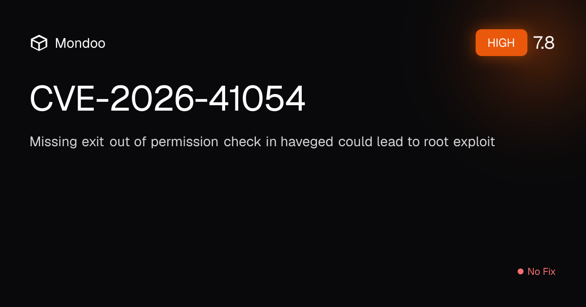

- Related coverage: mondoo.com
CVE-2026-41054 | Mondoo Vulnerability Intelligence
CVE-2026-41054 - HIGH severity: Missing exit out of permission check in haveged could lead to root exploitmondoo.com - Related coverage: linuxsecurity.com
