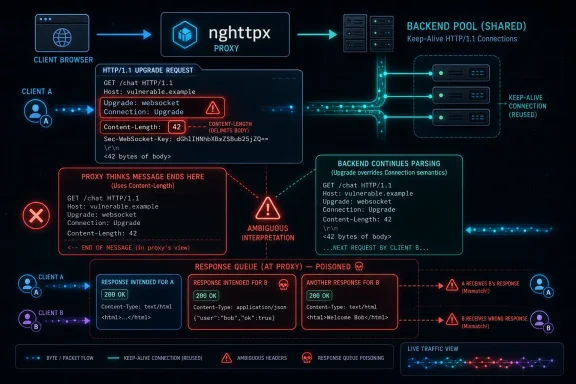

Request smuggling vulnerabilities usually begin with a simple premise: two components in the same HTTP path disagree about where one message ends and the next begins. That disagreement is often more dangerous than the malformed request itself, because the attacker does not need to compromise either component directly. They need only persuade the front end and the back end to read the same bytes differently.
CVE-2026-58055 follows that pattern, but with a twist that will feel familiar to anyone who has spent time around WebSocket gateways, HTTP/2 bridges, and layered reverse proxy stacks. The issue involves an HTTP/1.1 Upgrade request that also carries a Content-Length header and a body. According to the CVE description, nghttpx forwards that request to reusable keep-alive backend connections, re-adds Upgrade and Connection headers, and passes Content-Length through unchanged.
That combination matters because reusable backend connections are where isolation can quietly fail. A proxy may treat one inbound client request as finished, while the backend may still be parsing bytes that the attacker intended to become the beginning of another request. If a later client’s response is then matched against the wrong request in the queue, the vulnerability stops being abstract parser trivia and becomes cross-client response-queue poisoning.
This is why the advisory’s language is more alarming than the score might suggest. A CVSS 3.1 base score of 5.4 and a CVSS 4.0 base score of 6.3 place it in medium territory, with high attack complexity. But “medium” does not mean “ignore.” It means exploitation depends on deployment shape, backend behavior, and traffic patterns — precisely the sort of variables that make edge infrastructure hard to reason about.

The Dangerous Part Is Not Upgrade, It Is Ambiguity
Request smuggling vulnerabilities usually begin with a simple premise: two components in the same HTTP path disagree about where one message ends and the next begins. That disagreement is often more dangerous than the malformed request itself, because the attacker does not need to compromise either component directly. They need only persuade the front end and the back end to read the same bytes differently.CVE-2026-58055 follows that pattern, but with a twist that will feel familiar to anyone who has spent time around WebSocket gateways, HTTP/2 bridges, and layered reverse proxy stacks. The issue involves an HTTP/1.1 Upgrade request that also carries a Content-Length header and a body. According to the CVE description, nghttpx forwards that request to reusable keep-alive backend connections, re-adds Upgrade and Connection headers, and passes Content-Length through unchanged.
