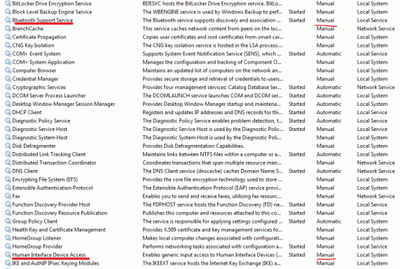

It is usually hard to tell if something is actually missing from a system. You might check the attachment and see if you show either of the items underlined.

Ah ok... I do have Bluetooth Support Service, which I had earlier changed to Automatic after reading that some people had success with that. I have changed it back to Manual. I also located the Human Interface Device Access - I was looking for "Hidserv" before. That is also set to Manual. However, after making sure both of these are set to Manual, I still have the problem.
I do have a couple other Bluetooth-related services: "Bluetooth Device Manager", "Bluetooth Media Service", and "Bluetooth OBEX Service." Do you know what these should be set to? I had set them all to Automatic before after reading of other people's successes... I think before one of these was Automatic and the rest were Manual, but I forget which ones were which. Sigh... I probably should have posted here before messing with all this stuff, but I wanted to try all possible solutions before bugging someone.
