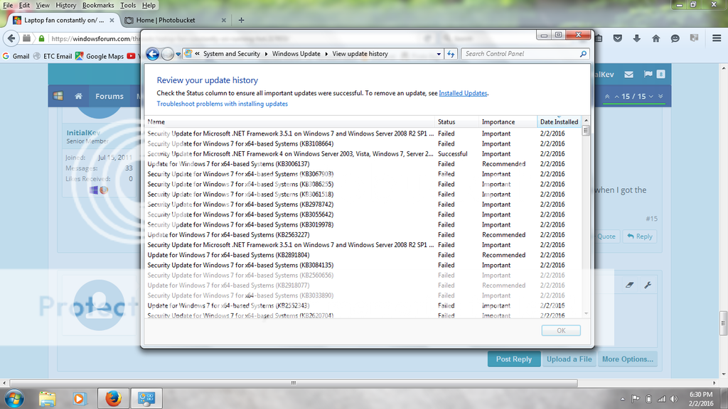

Can anyone suggest a good Dell forum? Also windows just installed 214 updates but it said it failed to configure the updates and is reverting the changes. This has never happened to me before.

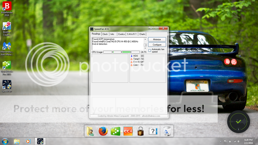

I would grab Speed Fan to check your CPU temperatures. SpeedFan - Access temperature sensor in your computer post a screenshot of your idle temps. If your computer is overheating I'd wager money that it's a problem with the heatsink. Either the vent is clogged with dust and/or the thermal paste/pad seal is broken or not applied correctly. If this is the case the computer will need to be taken apart, cleaned, and new paste applied. Arctic Silver is probably the best paste you can get.

Lastly re' the updates, when you mention that it's reverting the changes that could be an upgrade, do you know what the updates were exactly?

They're security updates. I had to basically reinstall Windows when I got the new drive so I guess it's trying to get back all the updates.

Yes it is. Try removing the dust first and see if that drops the heat any. Your system is running a tad warm looking at those temps but as I said above use google to find out what your temps should normally run at or ask at a laptop forum. If you do decide to re-apply the thermal paste try googling for youtube videos on your model for reapplying thermal paste. I've seen others out there for laptops so perhaps someone has done a vid for yours?
