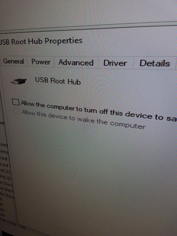

I just tried them all, only 3 had options for power management but the check box for allow to wake was greyed out

All of them show this and under properties of controller, no power management tab

You may need to look at the devices in usbview which is part of the Windows debug tool kit. See if you disable the power settings

All I can tell you is power management is pretty complicated and some devices don't support waking from different power levels. The wireless keyboard/mouse may not support it or the receiver is going to a device power level that is basically off. If that's the case the receiver would have no power and therefore not pick up any transmissions from the keyboard or mouse
