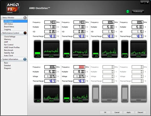

May I add, could you install AMD Overdrive and get us a screengrab of the CPU Status tab. Would be helpful to see what the thermal margin temps are at idle and under load.
This what you are looking for? I took two spaced about 10-15 minutes apart.

Post back with any updates
Downloading now, will post back how it goes.
