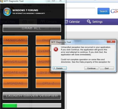

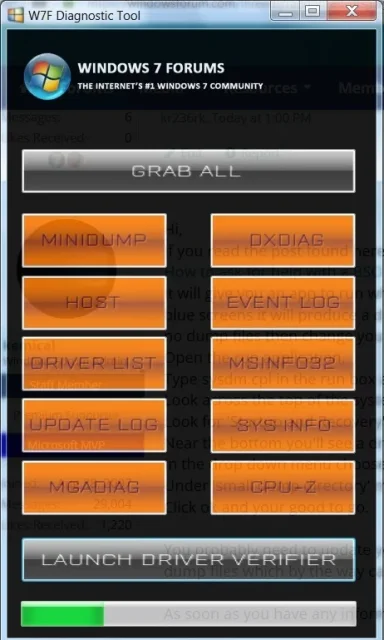

    Thanks, I am running the 'Grab All' option as administrator, but nothing seems to happen - the green progress line gets to about 1/3 across then idles.
    Please advise.

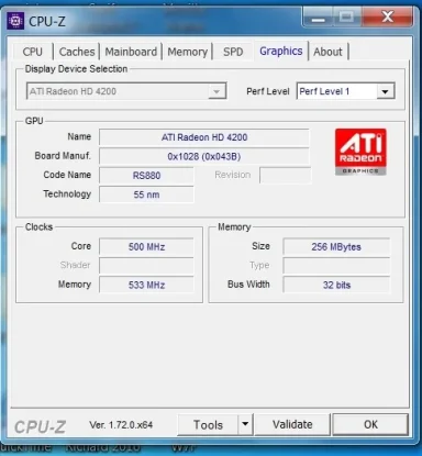

    Here is the graphic card info

    But this is all I get from Grab All - been running about 30 minutes now - green line just stops there :-|

    In that case look in your main Windows folder found on the C drive and look for a folder marked minidump. If it contains any dump files simply zip them up and post them in your next post. I'll pop back shortly and see if you have anything posted.
    If it doesn't contain any dump files then change the settings like i posted above. You will need to have another bsod for a dump file to be created.

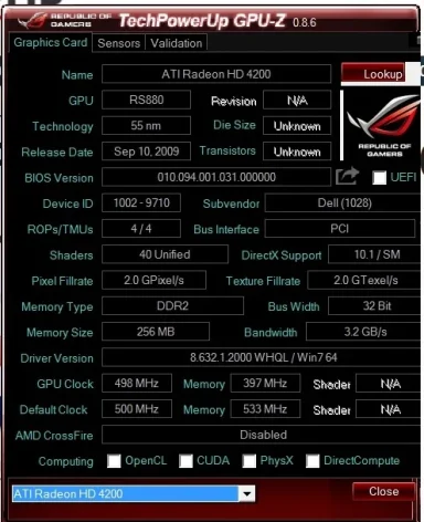

    atikmdag.sys Tue Aug 18 04:05:47 2009: AMD gpu driver. I see your using a Dell Inspiron 570, these can be fitted with a number of graphic cards. Try running this app to see which graphics your using if your unsure: GPU-Z

    The GPU-Z card details are here

    You can find the driver for that card here:
    Legacy
