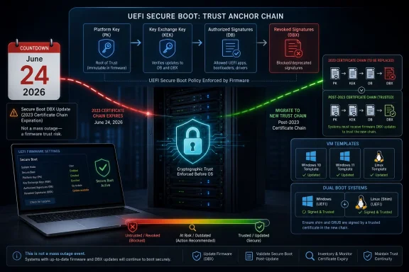

UEFI Secure Boot trust-anchor chain infographic showing certificate DBX updates and trusted boot status.The Secure Boot Deadline Is Not a Power-Off Event​
The most useful thing to say first is also the least dramatic: June 24 is not a mass outage date. A Windows laptop with old Secure Boot certificates will not necessarily refuse to start on Thursday morning. Users should not expect a Y2K-style cliff where millions of PCs suddenly stop at a firmware screen.
That does not make the deadline benign. Secure Boot’s certificate chain is not merely another Windows component that can be patched, rolled back, or reinstalled from the comfort of the operating system. Its keys live in UEFI firmware variables, and those variables decide what code is trusted before Windows has loaded, before endpoint security agents are active, and before most administrators have any visibility at all.
Microsoft’s own guidance frames the issue as a degradation of future early-boot protection. Devices that do not receive the 2023 certificates may continue to run and receive standard Windows updates, but they may not be able to receive future Secure Boot protections for boot managers, databases, revocation lists, and newly discovered boot-level vulnerabilities. That distinction matters because it separates availability from assurance. Your machine may work exactly as it did yesterday while silently losing part of its future defensive machinery.
The deadline also arrives in pieces. The Microsoft Corporation KEK CA 2011 expires on June 24, 2026. The Microsoft UEFI CA 2011, widely used for third-party bootloaders and EFI applications, follows on June 27. The Microsoft Windows Production PCA 2011, used for the Windows bootloader, expires on October 19. The calendar therefore creates not one failure mode, but a rolling certificate migration that touches firmware, Windows servicing, Linux boot shims, option ROMs, BitLocker behavior, and virtual machine templates.
Fifteen Years of Trust Are Ending in Firmware, Not Windows​
Secure Boot was introduced with the Windows 8 era as a response to a particular class of threat: malware that wants to run before the operating system. A bootkit does not need to beat Windows Defender at the Windows desktop if it can compromise the chain that loads Windows in the first place. Secure Boot’s job is to make that chain cryptographically boring.
At power-on, UEFI firmware checks pre-OS components against trust databases stored in firmware. The allowed database, usually called DB, contains trusted certificates and signatures. The forbidden database, DBX, contains signatures that should be blocked because they belong to known-vulnerable or malicious components. The firmware decides what can execute before the operating system is in a position to defend itself.
The authority structure sits above those databases. The Platform Key, normally controlled by the hardware maker or platform owner, anchors the Secure Boot policy. The Key Exchange Key, or KEK, authorizes updates to DB and DBX. Microsoft’s 2011 KEK has been one of the central mechanisms by which Windows devices receive Secure Boot database updates through the Windows servicing ecosystem.
That is why the KEK date is operationally more interesting than the average certificate expiry. If a browser certificate expires, the browser can reject a website or the site owner can install a replacement. If a code-signing certificate expires, software distribution can move to a new signature chain. But Secure Boot certificates are buried in the policy store that determines whether the next stage of boot is trusted at all.
The 2023 replacements are meant to carry that trust chain forward. Microsoft Corporation KEK 2K CA 2023 replaces the expiring KEK role. Windows UEFI CA 2023 takes over Windows bootloader signing. Microsoft UEFI CA 2023 and Microsoft Option ROM UEFI CA 2023 split duties that were previously bundled under the older Microsoft UEFI CA 2011. That restructuring is not cosmetic; it reflects a more granular view of what firmware should trust.
The DBX Is the Part Users Never See Until It Is Too Late​
The least visible part of Secure Boot is often the most consequential. DBX is the revocation list, and revocation is how the ecosystem responds when a boot component that was once trusted becomes dangerous. If a signed bootloader contains a vulnerability that attackers can abuse, Secure Boot cannot simply decide that signatures no longer matter. It needs a way to say: this particular signed thing is no longer acceptable.
That is what DBX updates are for. They allow Microsoft and the broader UEFI ecosystem to block known-bad or known-vulnerable boot components at firmware level. The machine does not have to wait for Windows to notice the attack. It can refuse to launch the offending component before the operating system starts.
BlackLotus made that abstract model painfully concrete. The bootkit showed that Secure Boot’s promise could be undermined by abusing vulnerable boot components and rollback paths. Microsoft’s response required staged mitigations because revoking boot components is risky: block too aggressively and legitimate systems may fail to start; move too slowly and attackers retain a path through the pre-OS chain.
That history should shape how administrators read this week’s certificate deadline. The danger is not that every machine missing the 2023 certificates becomes infected on June 25. The danger is that a machine can become stranded on an old early-boot trust baseline while future threats continue to evolve. In practical terms, the system may remain patched at the Windows layer while becoming stale at the firmware policy layer.
This is where some of the loudest phrasing around the deadline needs nuance. “Forever” is a powerful word, but firmware security is rarely that clean. Some devices may later be remediated through OEM firmware, supported servicing paths, manual key enrollment, or platform-specific recovery procedures. The real risk is narrower and still serious: if a device cannot receive or apply the 2023 certificate chain through a supported path, its ability to accept future Secure Boot trust and revocation updates can be impaired in a way ordinary Windows patching will not fix.

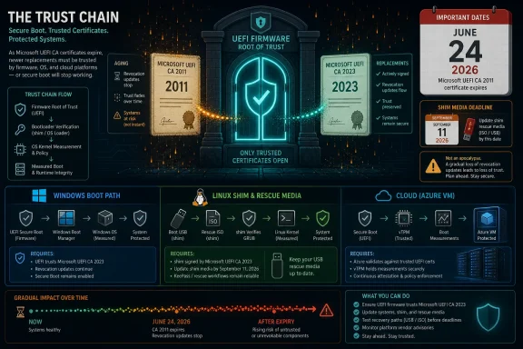

Microsoft’s 2011-era Secure Boot certificates begin expiring on June 24, 2026, with Linux-focused Microsoft UEFI signing dependencies following days later and shim-related media facing another deadline on September 11, creating a practical migration crunch for dual-boot users, recovery media, and some Azure Linux virtual machines. This is not a Y2K-style boot apocalypse. It is more awkward than that: a slow failure of trust plumbing that mostly stays invisible until the day an administrator needs it. The real risk is not that millions of machines suddenly refuse to start, but that the security chain beneath Windows, Linux, and cloud recovery workflows stops being renewable at the exact moment attackers are getting better at abusing the boot layer.
Infographic showing UEFI secure boot trust chain timeline, certification expiry on June 24, 2026, and update guidance.Secure Boot’s quiet paperwork problem has become an operational deadline​
Secure Boot was sold to most users as a simple firmware switch: on is safer, off is riskier. Underneath that switch is a certificate hierarchy that decides which bootloaders, option ROMs, and revocation updates a machine is allowed to trust. Microsoft sits at the center of that ecosystem because Windows dominates PC firmware defaults, and because many Linux distributions use Microsoft-signed shim bootloaders to make Secure Boot work on ordinary consumer and enterprise hardware.
That arrangement has always been a compromise. Linux did not become dependent on Microsoft because the open-source world loved the idea of Redmond blessing boot media. It happened because hardware vendors needed a broadly recognized trust anchor, and Microsoft’s keys became the lingua franca of UEFI Secure Boot on x86 PCs.
Now the oldest generation of that trust anchor is aging out. The Microsoft Corporation KEK CA 2011, Microsoft Corporation UEFI CA 2011, and Microsoft Windows Production PCA 2011 are all part of the 2011 certificate generation that must give way to 2023 replacements. The dates vary by certificate and purpose, but the near-term message is simple: the Secure Boot ecosystem is entering a planned but messy key rotation.
The word planned matters. Microsoft has published guidance, staged Windows changes, and provided mechanisms for administrators to check and deploy the new certificates. But planned does not mean painless, especially when the plan crosses firmware, operating systems, boot media, Linux distributions, hardware OEMs, cloud VM templates, and disaster recovery playbooks.
The machines may boot, but the trust chain stops moving​
The least helpful way to describe this transition is to say that PCs will “break” when a certificate expires. Most will not. A Windows 11 machine with an old Secure Boot certificate is not expected to turn into a paperweight at midnight, and existing bootloaders do not automatically become malware because the signing certificate has aged out.
The more accurate description is also the more worrying one: systems that have not moved to the 2023 certificates can enter a degraded security state. They may continue to start normally while losing the ability to receive future Secure Boot database and revocation updates. In practice, that means the machine is increasingly frozen in yesterday’s view of which boot components are trustworthy and which should be blocked.
That distinction matters for bootkits. Secure Boot is not magic, and it has had embarrassing bypasses, but its revocation machinery is one of the few scalable ways to respond when a signed boot component turns out to be exploitable. If a vulnerable bootloader needs to be blocked through a DBX update, a machine that cannot accept the relevant trust updates becomes a softer target over time.
This is why the expiry feels deceptively low-drama. Users may see nothing wrong on boot. Administrators may not see a failed update on Patch Tuesday. The damage is cumulative: fewer machines able to consume future boot-layer mitigations, more edge cases around recovery media, and more time spent untangling whether a failed boot is a certificate issue, a firmware issue, a BitLocker issue, or the usual chaos of aging PC fleets.
Linux is the canary because it lives outside the default Windows lane​
Linux users are hit by the most visible version of the problem because the desktop Linux Secure Boot path often runs through shim, a small first-stage bootloader signed in a way that common PC firmware will accept. Shim then hands off to the distribution’s own bootloader and policy. It is a clever bridge between Microsoft-dominated firmware trust and the more plural Linux world.
That bridge depends on the certificates present in firmware. A distribution can ship an updated shim signed with newer 2023-era keys, but that does not help if the target PC only recognizes the older 2011 trust chain. Conversely, old installation media may boot fine on old machines but run into trouble on hardware and firmware images that have moved forward.
This is where the September 11 shim-related deadline becomes more than trivia for distro maintainers. Installation media, rescue USB sticks, imaging tools, and long-lived enterprise build environments often sit untouched for months or years. The day they are needed is usually the worst possible day to discover that the boot path depends on a certificate generation the target platform no longer accepts.
For Linux desktop users, the temptation will be to disable Secure Boot and move on. That may be a reasonable temporary troubleshooting step, particularly for hobbyist systems. But for organizations that promised auditors, customers, or themselves that Secure Boot is part of their baseline, flipping it off is not a fix. It is an admission that the trust chain was never treated as maintainable infrastructure.
